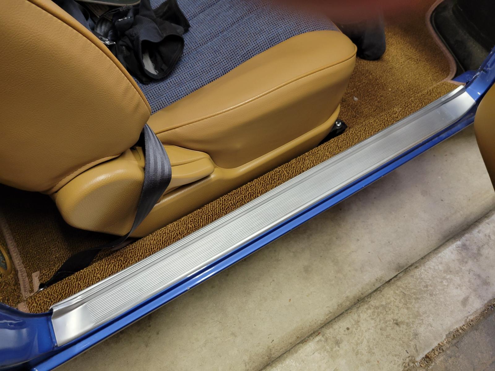

What is a good way to clean up aluminum door sills?
Max

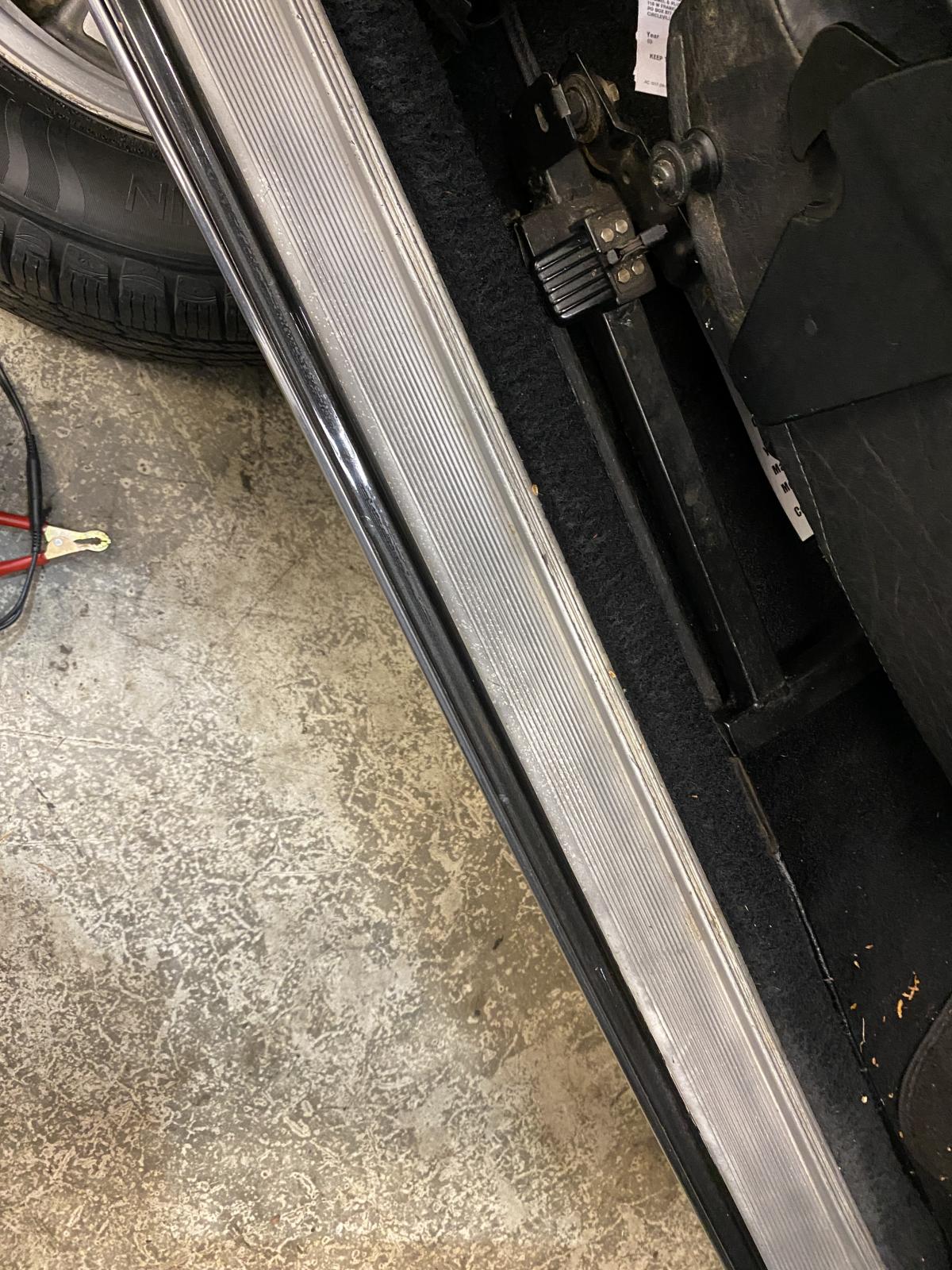

PostPosted: Tue Apr 08, 2025 3:31 pm    Post subject: Re: Cleaning Aluminum Door Sills? Reply with quote
Max

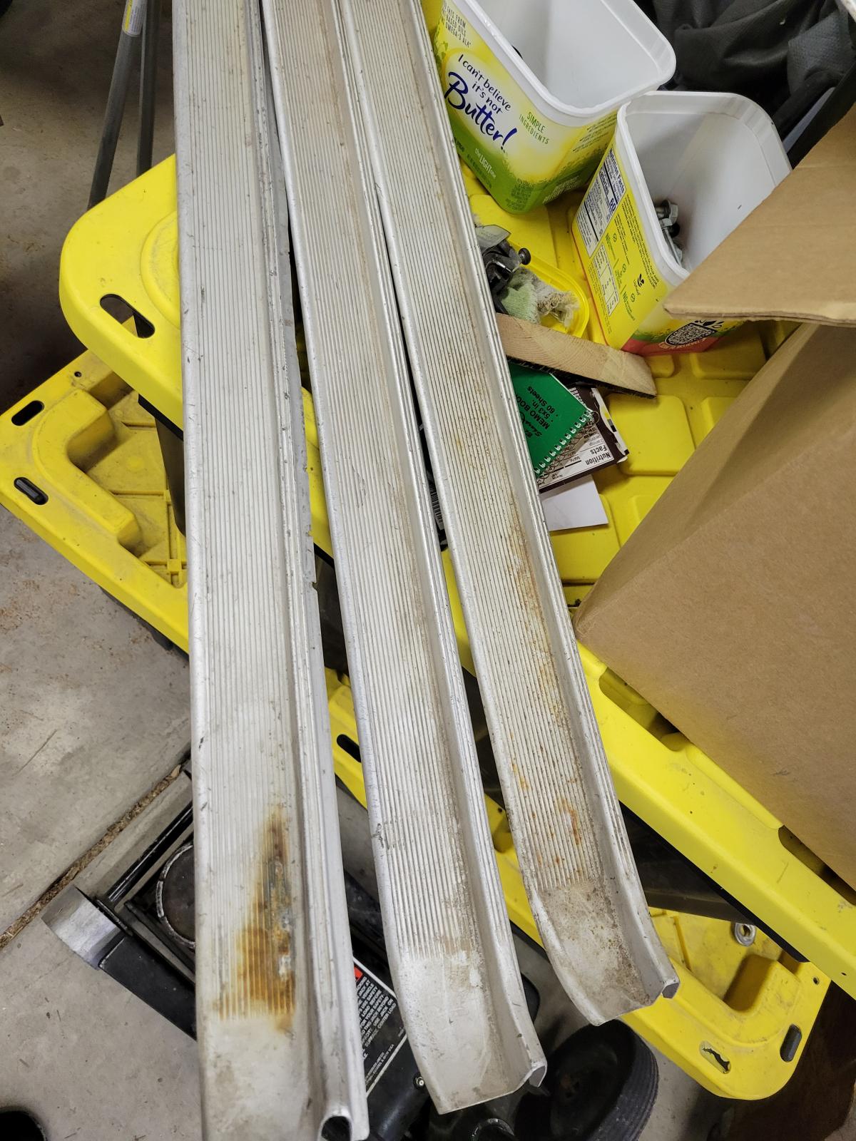

I have an old beetle sill and tried a wire brush. It left nasty marks. Glad I tried it on something I don't care about. I need a much softer brush. Wink
And I'll make a long tray so I can soak these in evaporust.

Keep in mind those sill plates are anodized aluminum, which is why they scratch so easily. In your case Max, it looks like you have grinding dust imbedded in them that got left out in the rain (which caused the rust).
You'll probably have to sand them out, and spray paint them, or maybe even powder coat them, as I don't know if having them anodized again will fix them. The aluminum is soft, so keep that in mind, whatever you do to them.

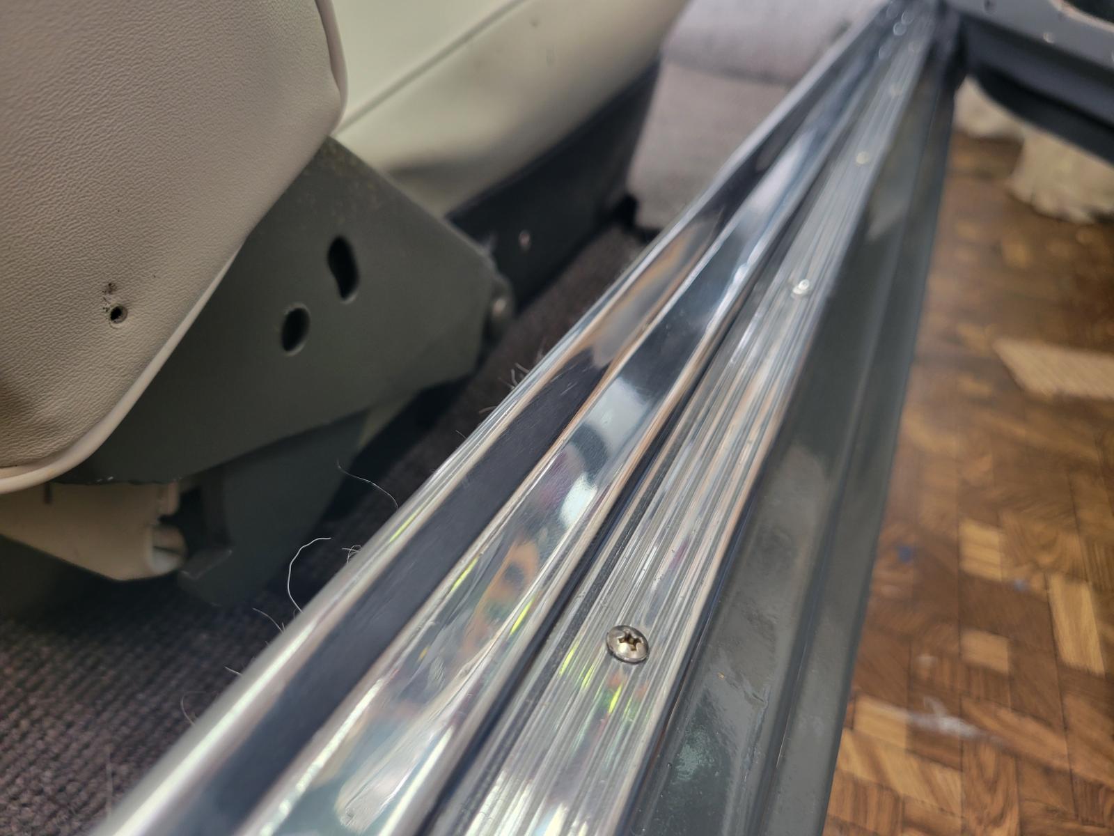

PostPosted: Sat May 03, 2025 5:34 am    Post subject: Re: Cleaning Aluminum Door Sills? Reply with quote
Here's mine that I beadblasted and used mothers on. Probably could use another polishing.
