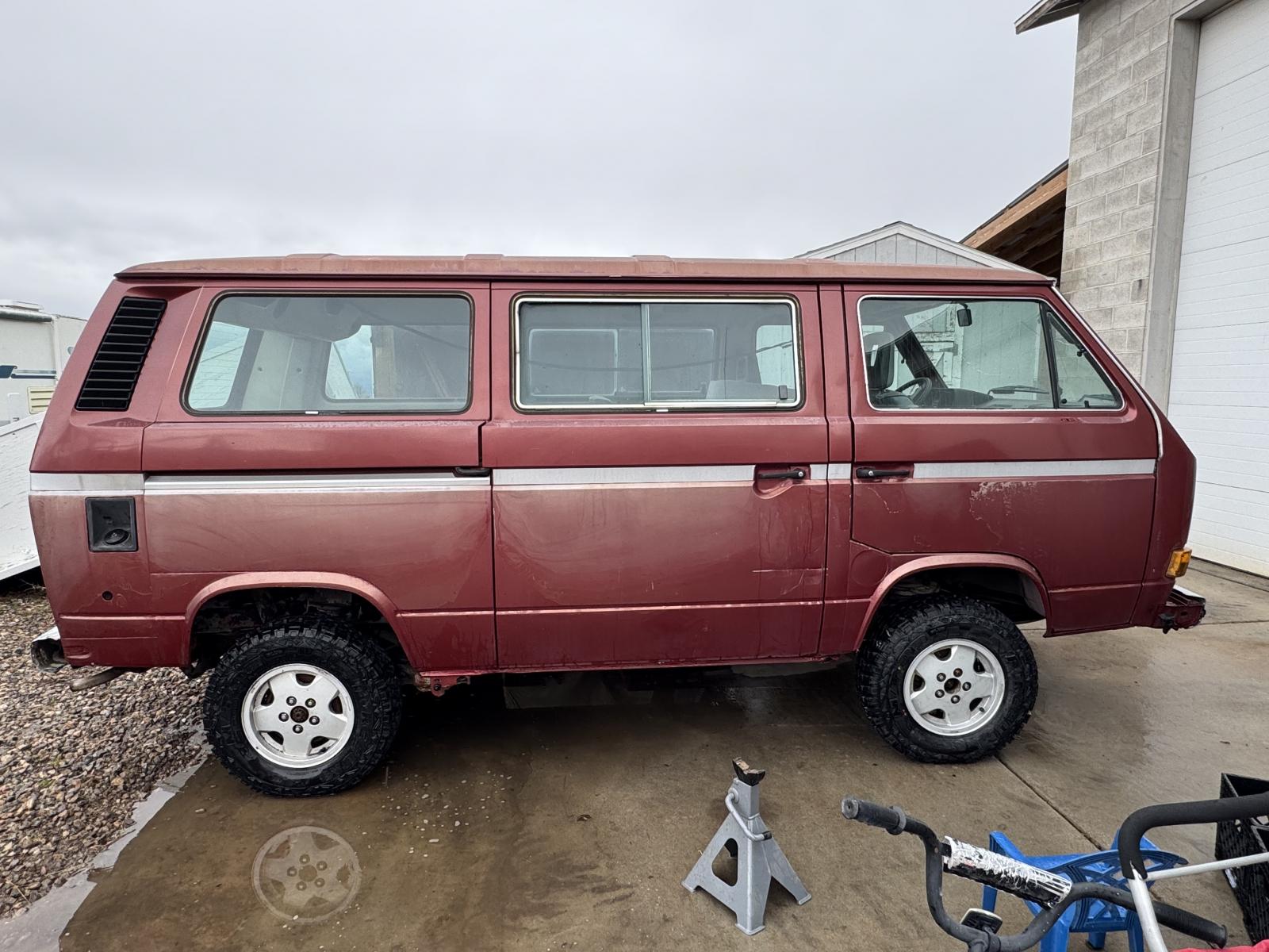

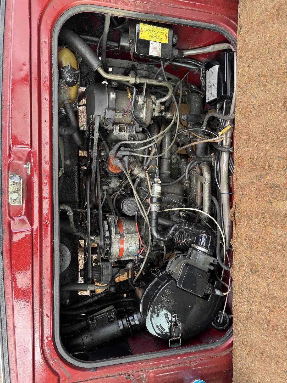

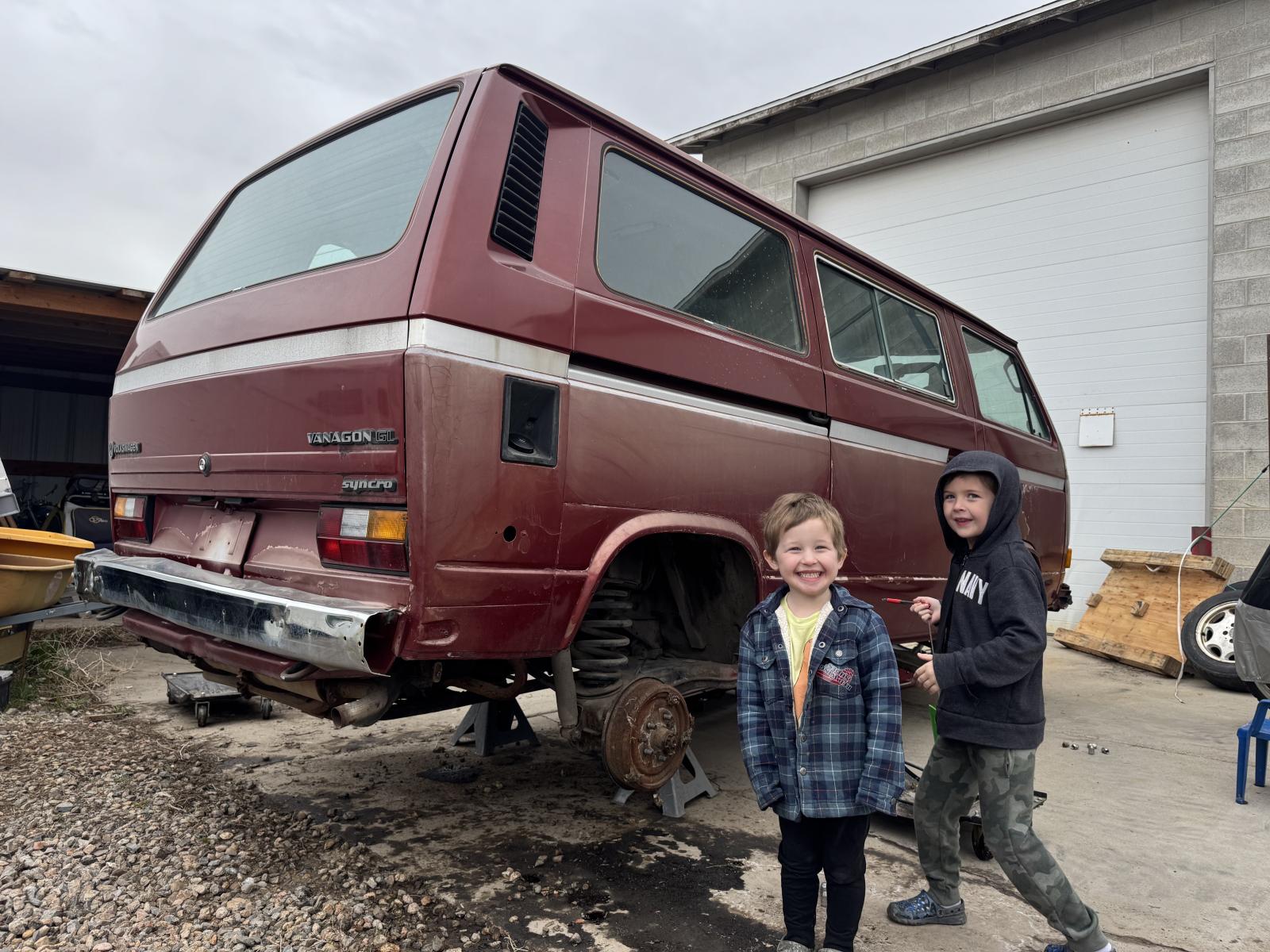

Shocked well I jumped head first into this Syncro. It popped up on our local classifieds and the seller had posted one about a month ago that was silver and sold immediately so when I saw this one I jumped on it for $3,000. The guys had repossessed a bunch of Vanagons from a shop I guess and got titles for them as a tow company. I registered this and I’m real excited to get it going again. I have several questions and welcome any and all opinions. Hopefully together we can get this back on the road. I’ve owned one other Syncro which was this same color but very very rusty and sold it in short order as it was too much metal work for me to confidentially tackle. This one is luckily really dry as far as the body goes. With around 118,000 miles on the clock it’s a gem in my book.
I know it’s sat for about 20 years or more. I took the vice grips off the fuel line thinking the tank was dry and sadly the next day realized it wasn’t. A forbidden molasses type gooey mix was what we found underneath. I poured about 3 gallons of gas into the tank after breaking the gas cap which was stuck solid. The fill cap area looks rusty- I hope little or no water got into the tank. I have a borescope to look into it tonight after I get home from work and we’ll see I bought a cap from orylies but it actually wasn’t for a Syncro but a 2nd and didn’t fit sadly.

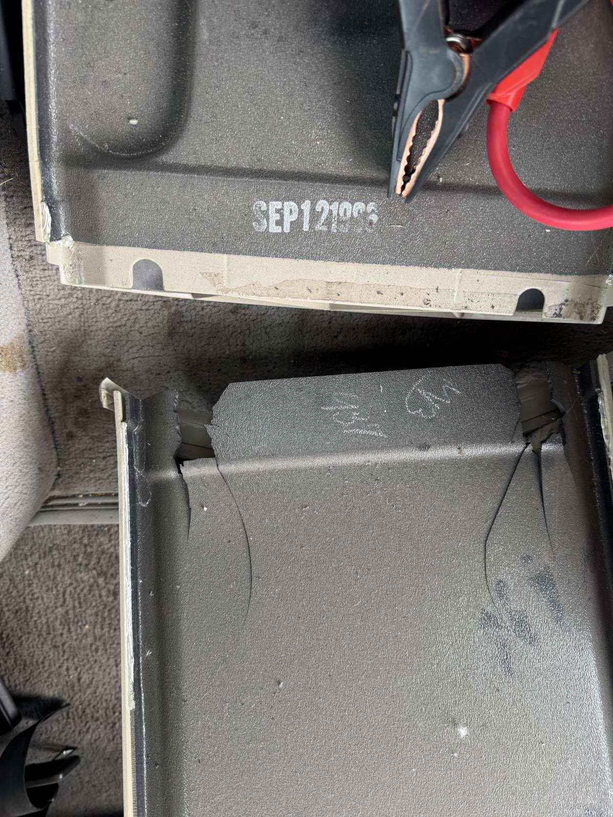

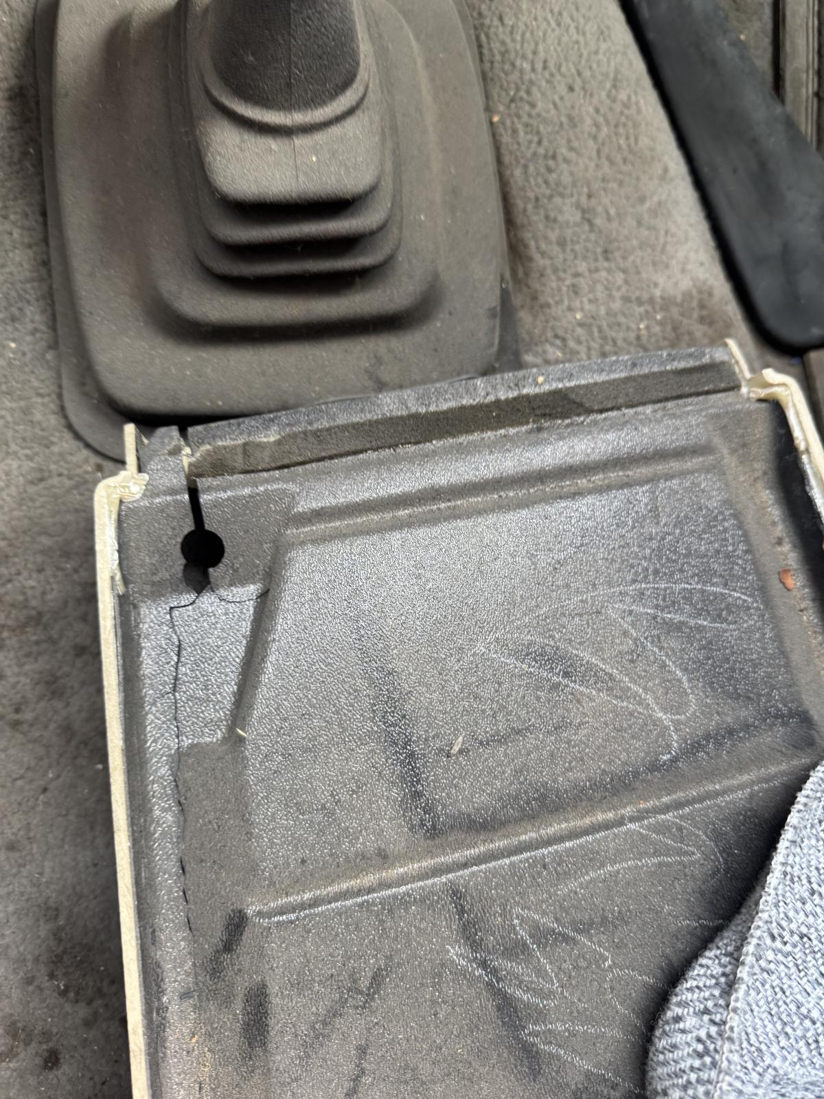

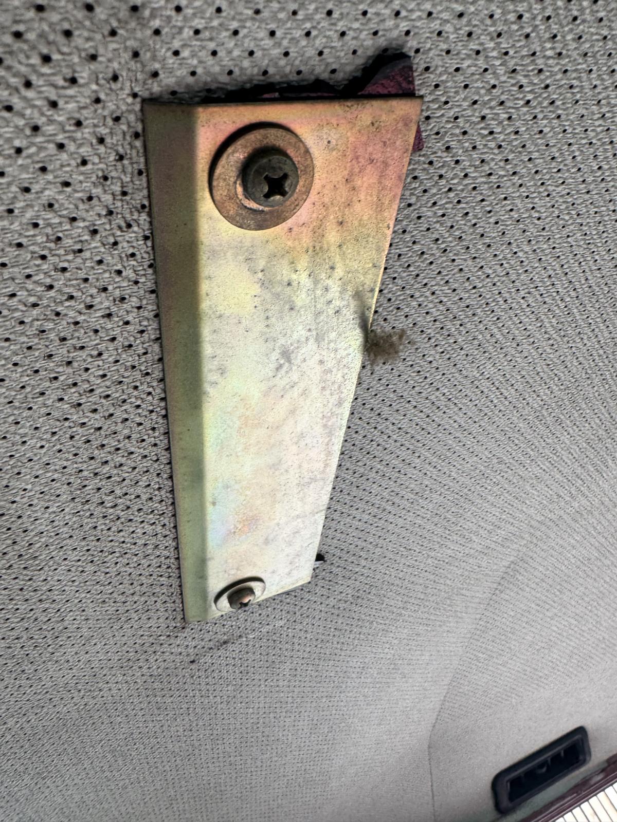

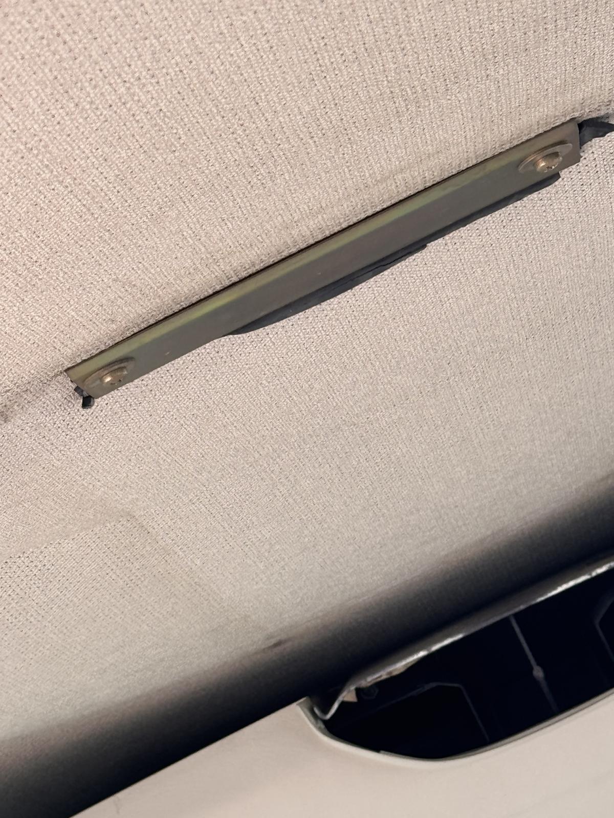

A big concern is the ac venting that looks like it straight up just got too brittle and fell right off. What do you think, is there any saving this mess? Better to try and find some from another van to install? Maybe can I just use the ac if it works and blast it out the back and just not have these ducts?
I’m pretty excited to take this on. Here’s the options sticker that’s still under the dash.
So far I’ve tried flushing the tank and after like 3 gallons it did start coming out clear. We’ll take a peak inside tonight.
I’m worried because there’s hardly any coolant in the system, none in the overflow or tank. Maybe it seeped out of somewhere? I’ve got more to put in this week. I found a receipt for head gaskets being done previously. Hope they didn’t blow again.

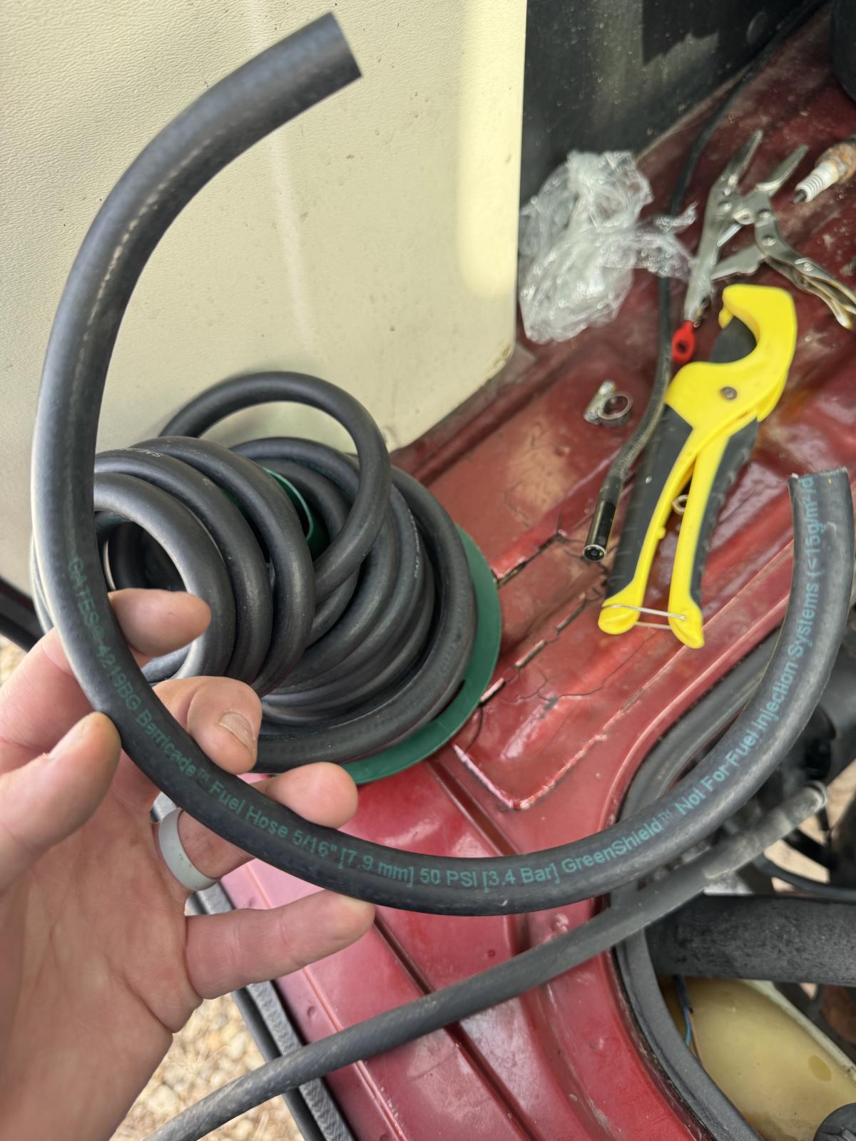

I got new fuel line to replace all fuel line.
I got a new Bosch fuel pump. The fuel pump was missing when I bought it, so I hope it was parked for that reason and not a lack of coolant.
I got new spark plugs, will check cylinders to see if any water got in.
Plan to change the oil and add marvel mystery oil after some sea foam flush in the old oil for a little bit. Is that okay or will it eat at seals?
I got a new little boot that was torn that goes before the air box after the piping that comes from behind the passenger tail light. What’s the little box for in there?? Does it collect water or something and need to be emptied?
Got some 27x8.5r14 tires from Amazon to roll with for now.
Got some truck mirrors I’m real excited about mostly for fun.

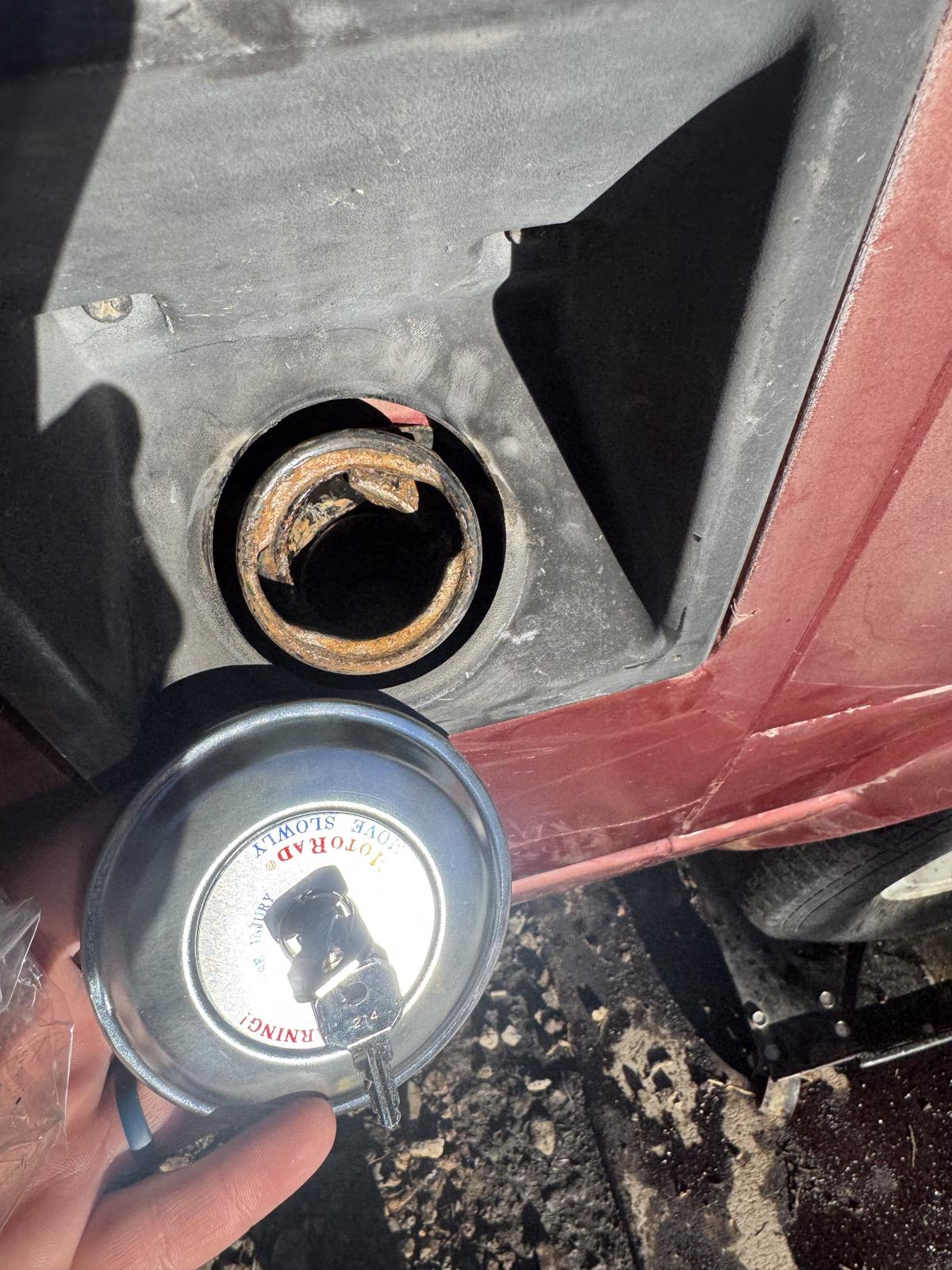

Got a locking gas cap that’s actually for a Syncro.
What do you guys think, is there anything that’s missing to just get it up and running? I had it going on starter fluid for a bit after several cycles to get oil around and it sounded great. What else would you do before getting it back on the road? I plan to get it going then do more maintenance as I use it. What’s your go to list or things off the top of your head?

I will replace everything that I can! Today I will be tackling the fuel lines. Next will be coolant hoses followed by vacuum lines and any other rubber parts.

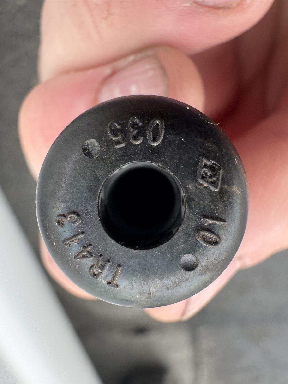

Jack and I got to work yesterday while the weather was nice and replaced the spark plugs. We figured we’d take compression while they old spark plugs were out. All cylinders read around 100psi so it seems healthy.
Check out the first fuel clamp off an injector, it was easy to just break off which concerned me. I guess it’s a good thing they’re getting replaced with stainless steel clamps and obviously new fuel line all around.

NOT GOOD! I thought Amazon sent the wrong fuel line, but it turns out I was a confused duface and ordered some good old low pressure fuel line for a carburetor setup. Glad I read the hose before installing any of it! I pulled a line to start and the lettering was well preserved under a heat sleeve. Looks like it was made the 42nd week of ‘86? That’s what I figure but who knows. Do you? I do believe/know it’s the original fuel line which is terrifying haha. I’m excited to get some high quality 300psi working load fuel line rated for all fuels and such. I had totally just ordered the wrong one. Silly me. Check out the wrong hose- I cut a piece dang it! And the original hose.
Bad hose line to use on a fuel injected system when it straight up says don’t use for fuel injected system. 50psi would have blown fast. I wonder how many have gone up in smoke (no pun intended Cheech and Chong) because of this simple mistake or not reading the actual rating of the hose?
42/86 date stamp or do you know something I don’t?

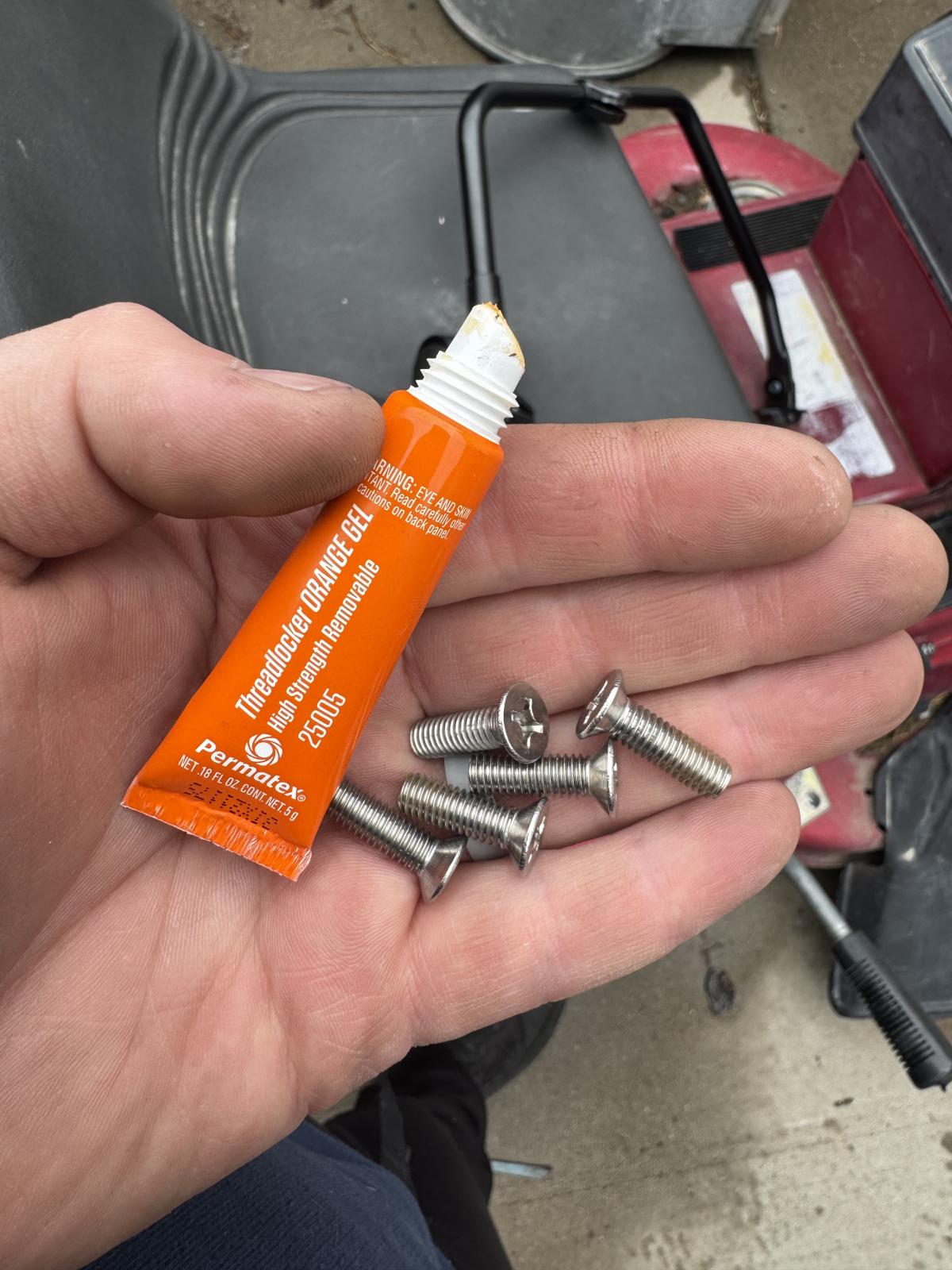

Also I’m very sad to spend nearly $500 on truck mirrors for them to not come with the dang gaskets and bolts. I re-use the same hardware then have to buy some to fit the upper bracket? Am I crazy here wondering why they can’t include a few more bolts when I pay stupid money for some mirrors? I’ll be hitting Ace tomorrow for some stainless steel bolts unless I’ve got some on hand in the rivnut kit which I might use to secure the top bracket- unless anyone has any other advice on doing that or I jump the gun and use self tappers promising myself I rivnut later on in life but never actually do. The driver side mirror is gone with its bolts so that’s a bummer or else I’d just reuse em.
I hope your kit came with the mirror spacer, and if so, don’t forget to have it installed before marking/drilling the holes for the rivnuts. It will slightly push the mirror to the side and position it in the right location to drill the holes.
I didn’t do that for my first mirror, and my hole ended up slightly overlapping a structural part of the door, not allowing the installation of the rivnut (had to very patiently file away insider metal to fit the rivnut). I think I have a post somewhere where I asked about it and how terrified I was of having screwed my door completely.

Got new tires installed yesterday! They’re only an inch or two bigger than stock by comparison. They are 27/8.5r14 on the original alloys. I have had this same size tire on our 1.8t westy and it was awesome. I think it’s the biggest I’d feel comfortable running on the stock 2.1 motor. The other ones on the westy are general grabbers which are nice. I’ve heard these ones are quieter from reviews on Amazon where I bought them from. They ran me $500. I put new valves in and when taking the old valve stems out from the old ones I noticed they were all different which was weird I thought. Anyway, I love how these look! Here’s the title on the Amazon listing so you can get ya some if interested or if you find a problem with using them I’m extremely open to knowing what you think you won’t hurt my feelings telling me I’ve made a mistake I appreciate all opinions and insights :
Forceum M/T 08 Plus Mud Off-Road Light Truck Radial Tire-27X8.50R14LT 27X8.50X14 27X8.50-14 95Q Load Range C LRC 6-Ply BSW Black Side Wall

I hope your kit came with the mirror Surprised spacer, and if so, don’t forget to have it installed before marking/drilling the holes for the rivnuts. It will slightly push the mirror to the side and position it in the right location to drill the holes.
UPDATE: found the thread describing the mistake I made while installing the mirrors
https://www.thesamba.com/vw/forum/viewtopic.php?t=720821
Okay I did read that and still struggled with the rivnuts haha. Mostly because my tool was too large to get that side on in correctly. It still worked but was insanely hard to screw into maybe I cross threaded it not sure. It’s on there though! The rivnut made it stick out a bit and I wish I had used self tappers but all the screws now match so whatever.

Tires from a quad runner? Havent seen such sized MT tires before. Interesting!!!

I looked at those tires for my 1wd but stayed with the Grabbers, I’ve been happy with them.
Utah tires, fer sure! Wink
