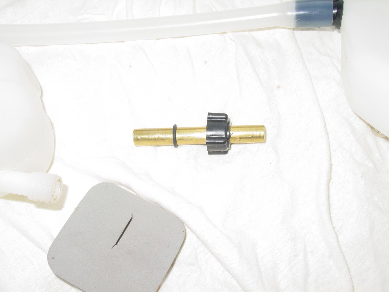

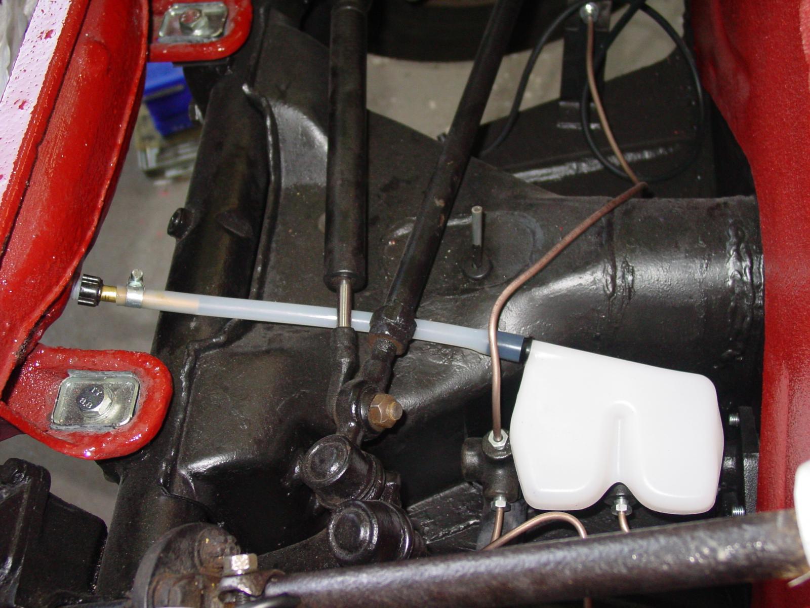

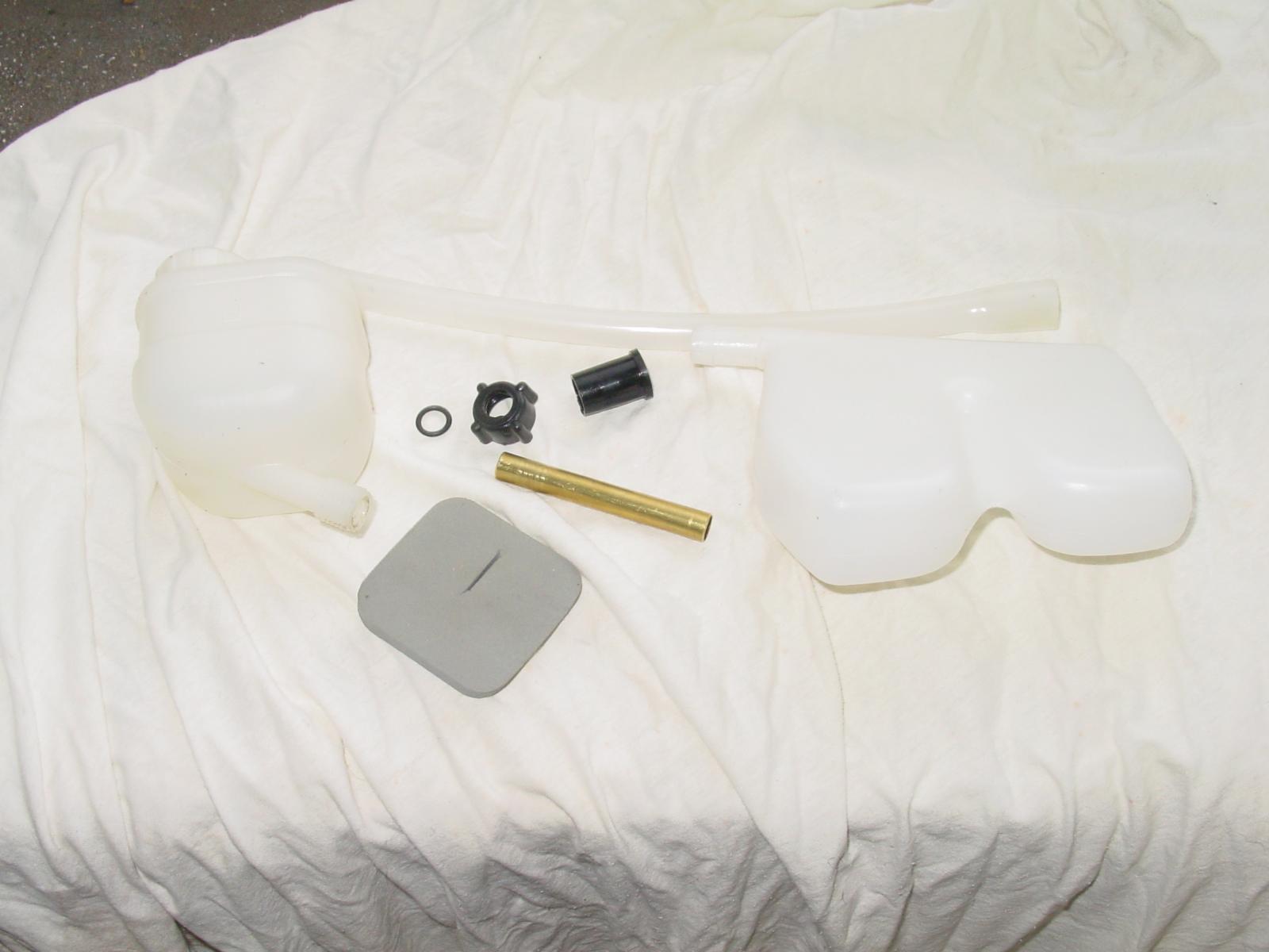

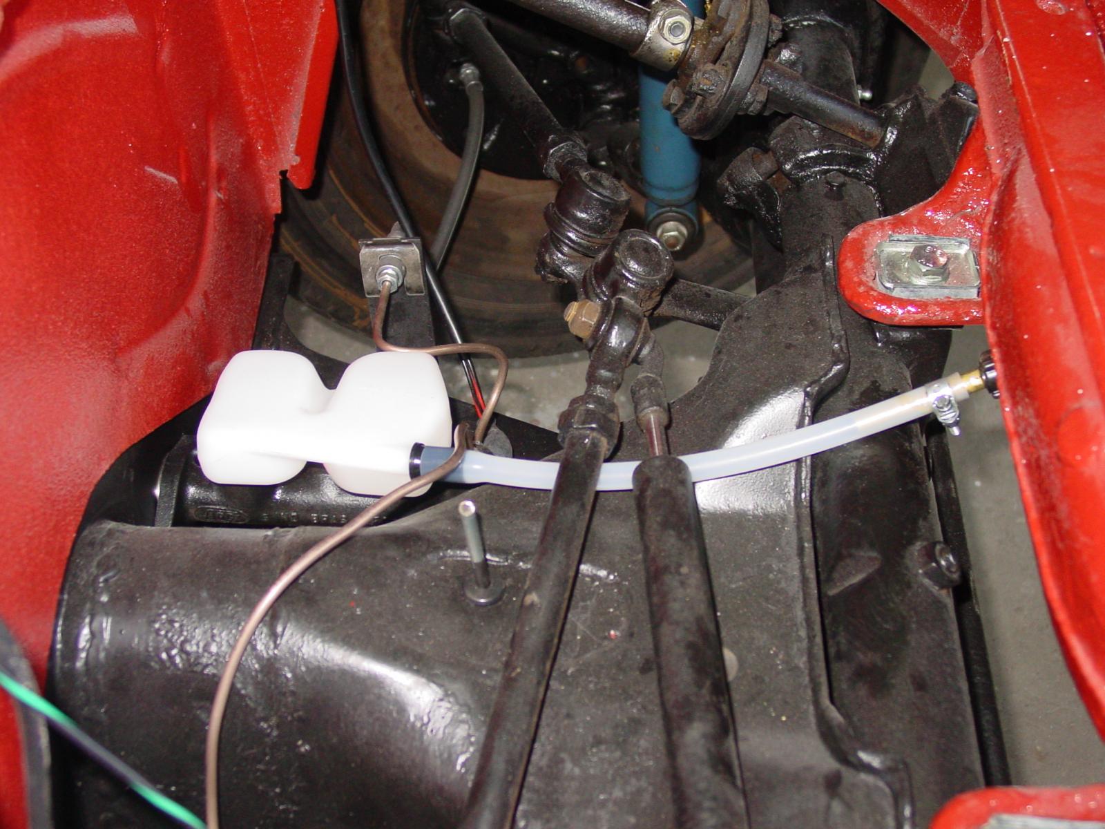

I have another option.
I use it on cars where you shoudn't see or smell anything other then "genuine VW".
Pictures are from a 65 I did last year, but it is similar to your 61.
Reservoir on the right is from a T2b
Simple 10mm adapter tube and common o-ring
How it will fit
Done!

A parts list for those who want to copy the conversation:
No. part number description
1 113 611 301 G fluid reservoir 1, upper, opened up for connector to 10mm
2 211 611 313 J fluid reservoir 2, lower
3 211 611 805 E tube, cut to lenght
4 211 611 833 D rubber gasket
5 selfmade connector tube 10x1x40
6 common rubber-o-ring 11x1
7 common tube clamp 12
Good luck
