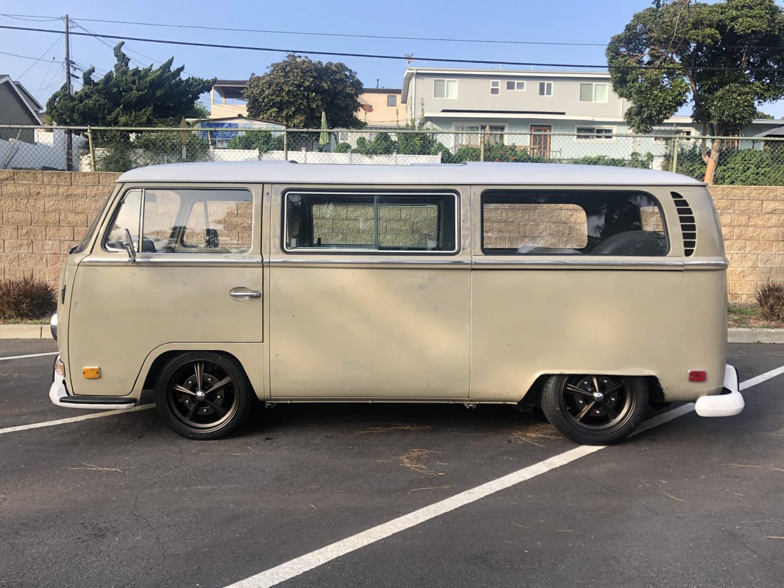

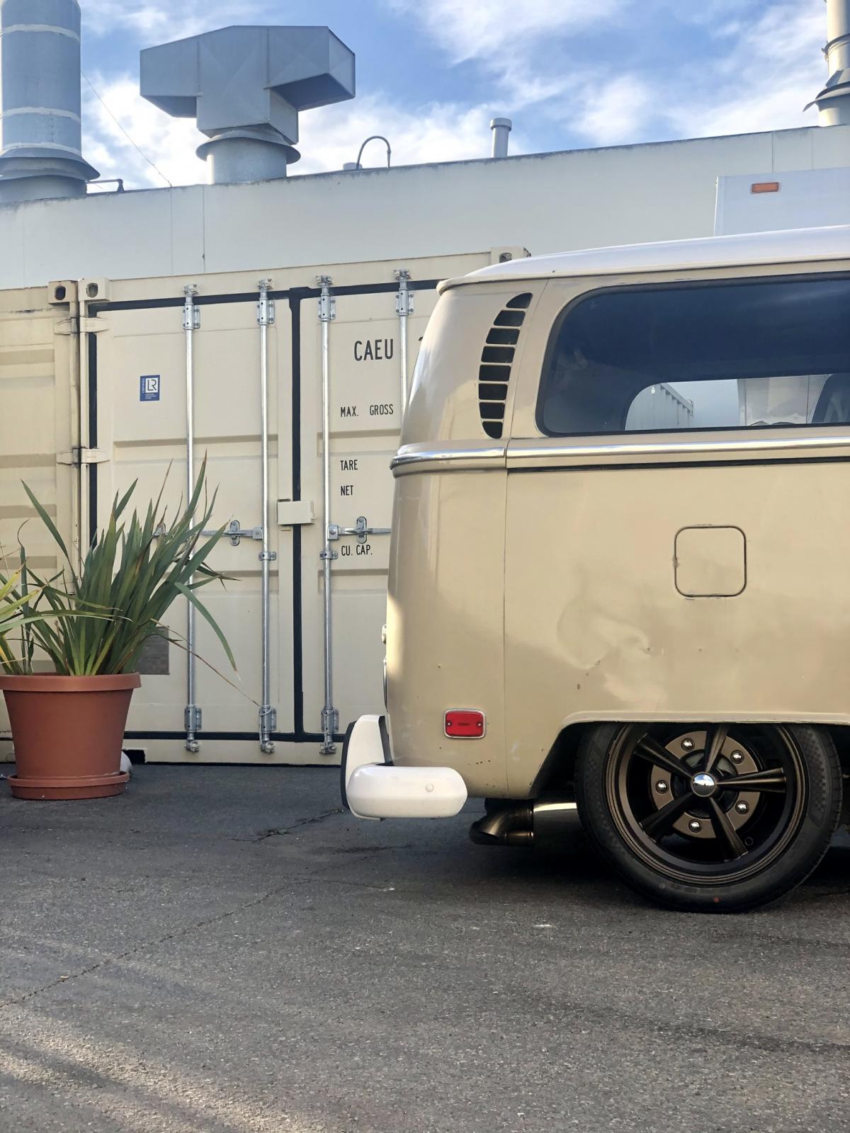

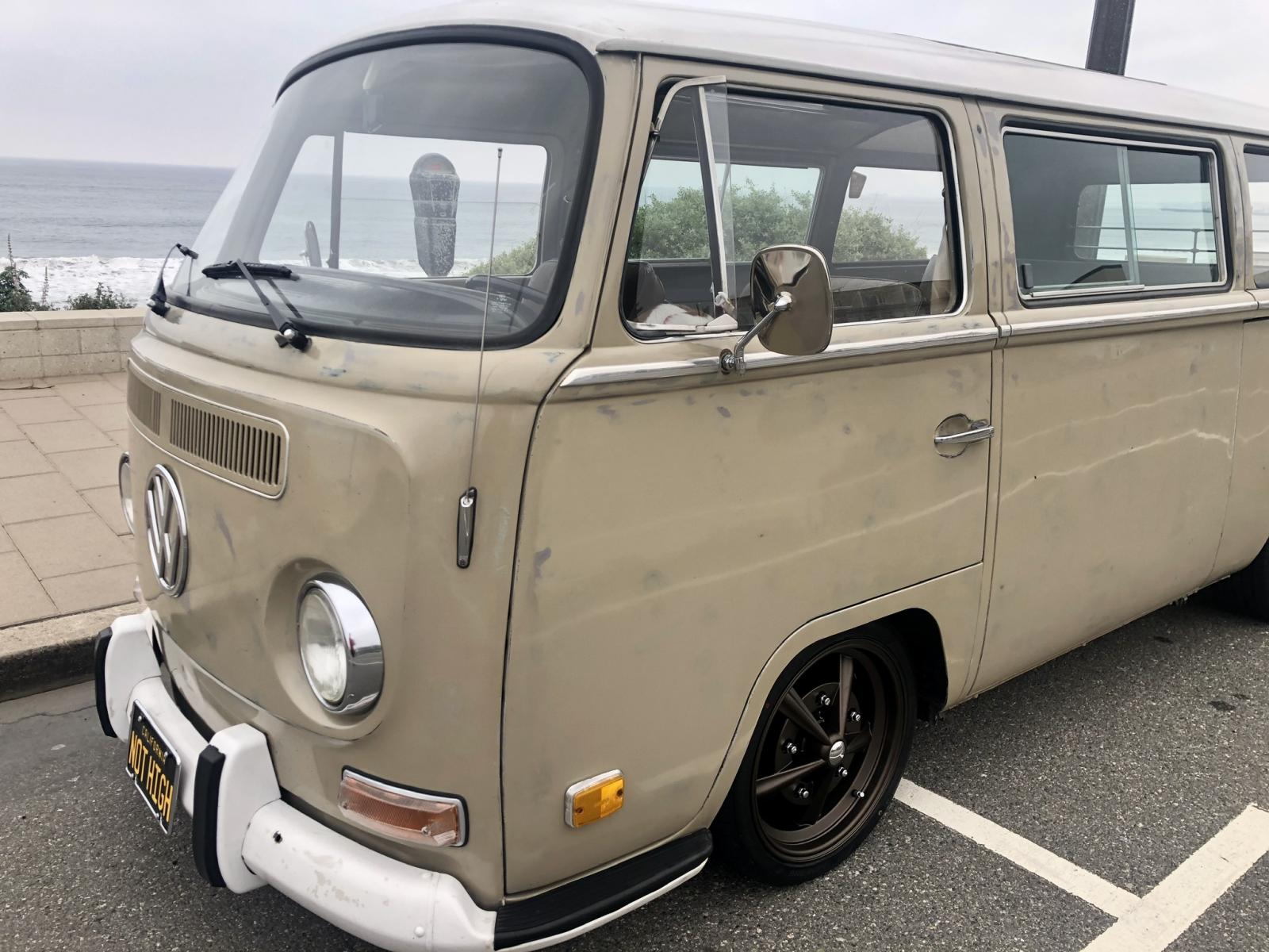

That will work for sure. Nearly identical to my set up with 17's, except I'm using a 205/40 tire in front. About as low as you can go without tubs in front.
