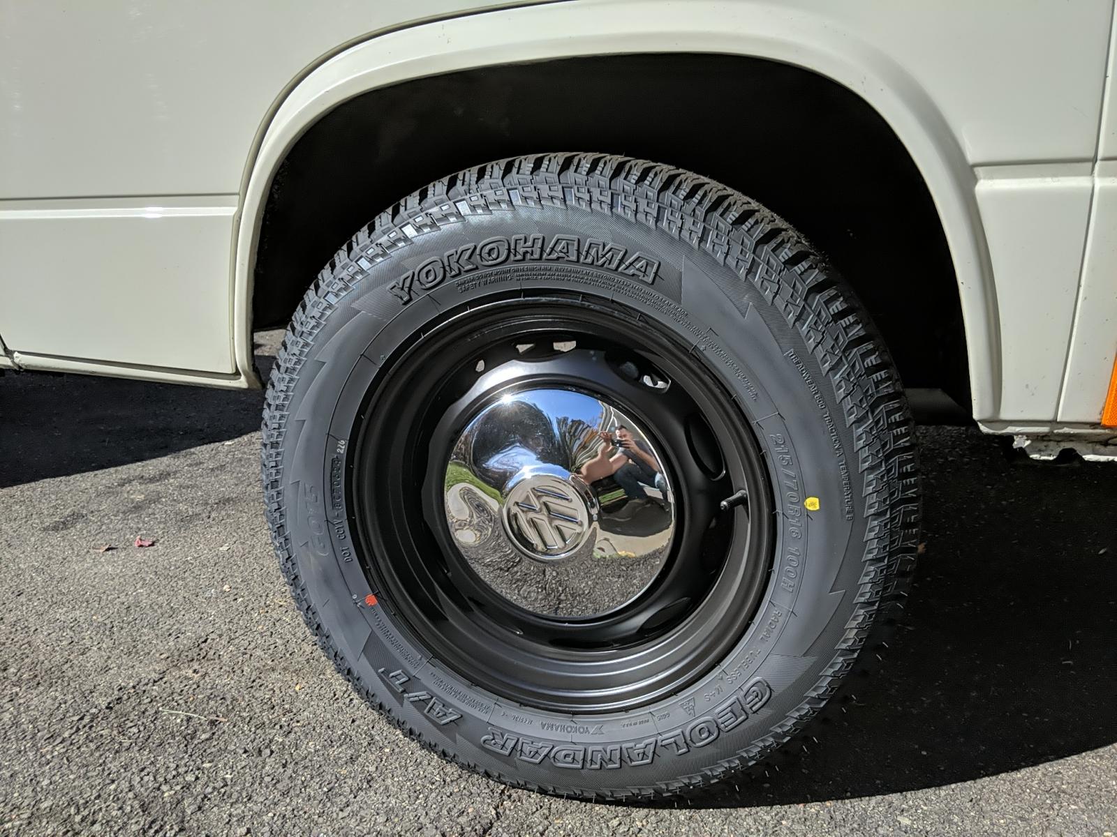

Mobelwagen Interceptor 512B with Yokohama Geolandar A/T in 215/70-R16. Schwenk Westy springs which are a near-stock height (less than 1" lift). I like these Interceptor wheels because they accept the OEM style hubcaps for a period-correct look, and because they're light at 23 lbs each. I don't like the 7.5" width, which fits, but is less than ideal. A 6.5" wheel width would be a better match for a 215 tire.
Amazing. Thanks!

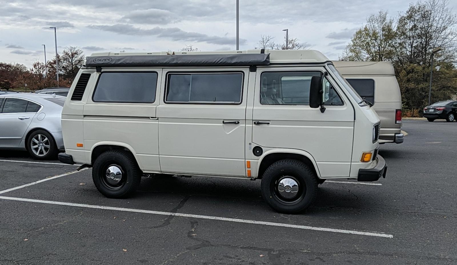

PostPosted: Fri Nov 15, 2024 11:59 am    Post subject: Re: "What wheels fit?" The ultimate wheel post. Reply with quote
I got stuck overthinking things but then finally read the fine print on ASA Type 9 : these rims eliminate need for spacers/new lugs/stud changes etc etc… makes life simple Cool I got the 16x7.5 from tire rack. 215/65/16 Grabber. No ET issues. Stock suspension. PERFECT FITMENT. Absolutely no issues on hard turns or speed bumps.
Much smoother and really stable ride.

PostPosted: Tue Dec 10, 2024 11:21 am    Post subject: Re: "What wheels fit?" The ultimate wheel post. Reply with quote
205/80r16s on a gowesty lifted Multivan. Cheap tires but they ride well and will probably dry rot before I wear them out.

You are correct Mud Terrains
LOL No Secrects Laughing I thought you could see them on there. These aren't the tires for the majority of our sophisticated compadres on this site. But I like em so far. ONly have have 500 miles on them.

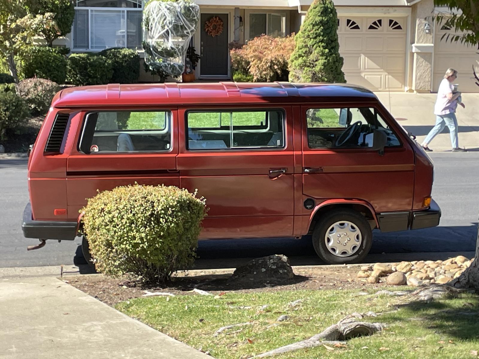

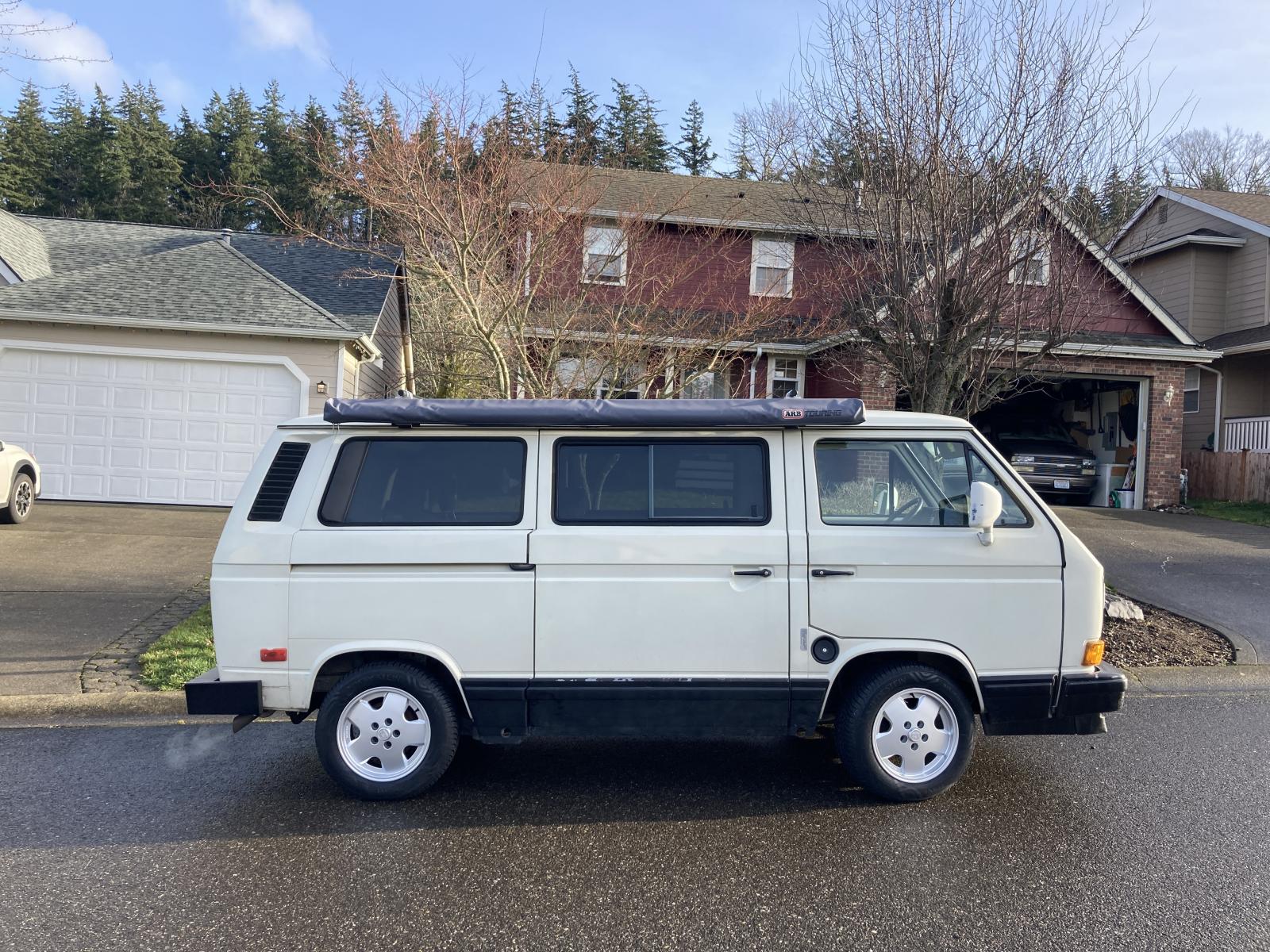

Here's my van with the new GoWesty OEM-look wheels mounted. These are 16x7.5-inch wheels with 215/60R16 Vredestein Quatrac tires. Everything fits nicely, except the sliding door rubs the right-rear tire a decent bit. I can open the door, but I'm worried a zealous passenger could damage the sidewall.
The look of these GW wheels is great—a bit over-branded, but they got the OEM look just right. The change in sizing has made for a great improvement in braking, handling, and highway speeds. Acceleration feels the same around town but is a bit slower from 40 to 60mph.
Here's a "before" pic for comparison. 14" steelies on low mileage but old 185R14 Hankook Vantras.
Overall, I'm happy.

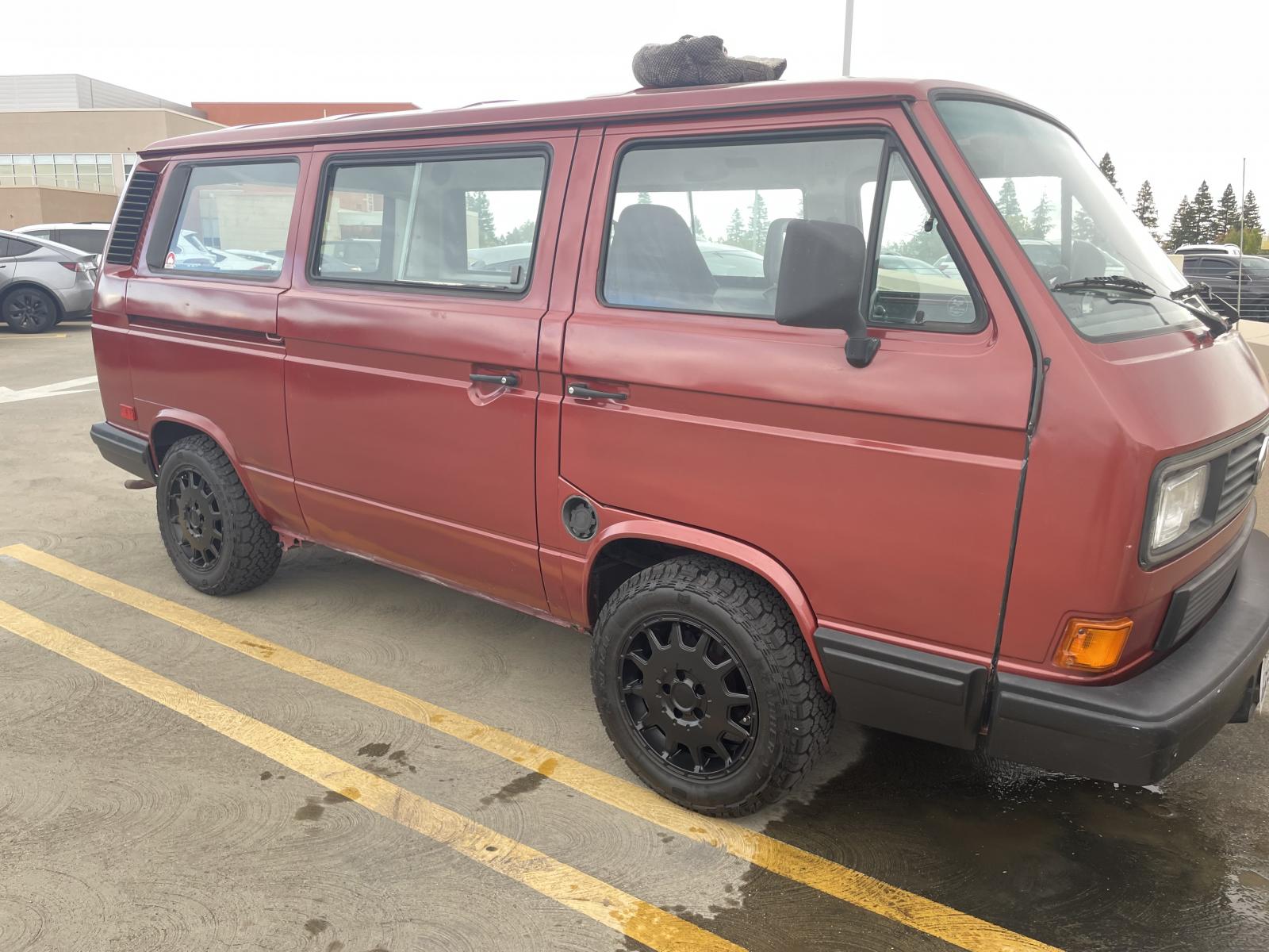

I’ve been running Ronal R9s since I first saw them used by Project Zwo in Europe. They work great. Good clearances etc. I have two sets…one for streets and the others snow.

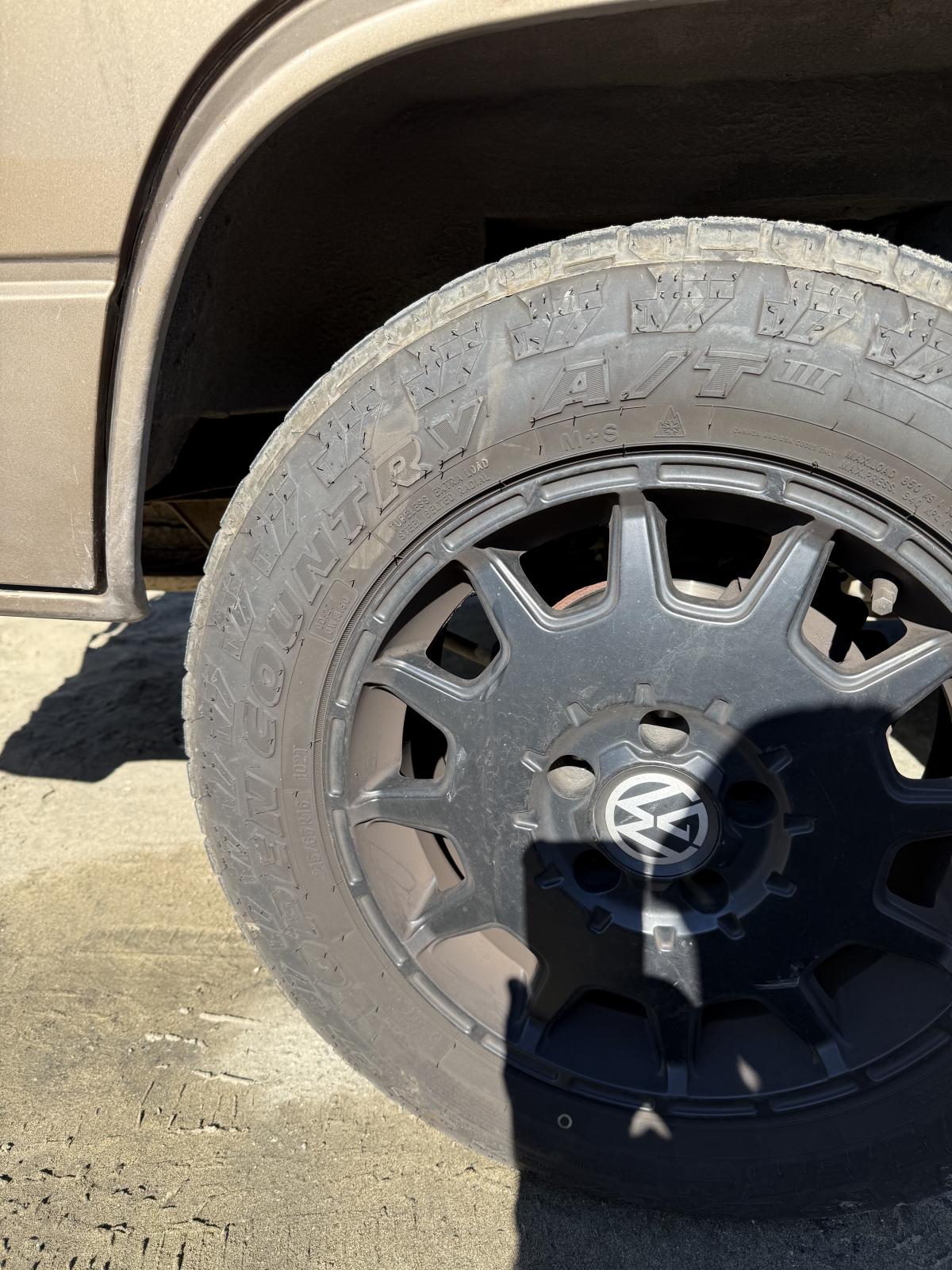

After lurking wheel fitment posts for months, I decided to try the Maxilite wheels and KO2’s. I would have liked 15” wheels for the sidewall profile, and I liked the old 14” KO2’s more square profile. The slider is .5-.75 clearance. Balancing was a little heavy because I didn’t want outer face weights.
