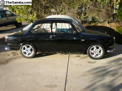

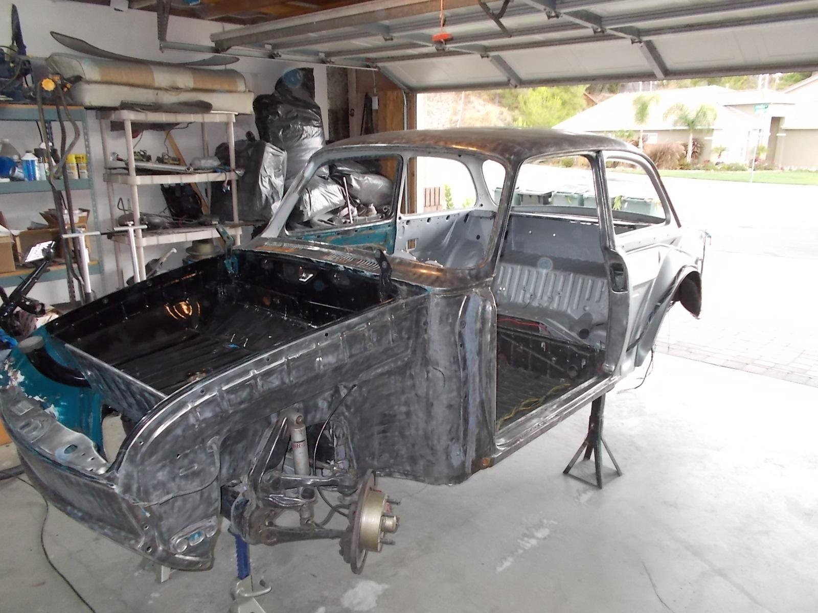

Well since my 1964 Notchback is hopefully heading towards the final stages I thought I would start my build thread. Maybe I should of started this thread 3 years ago when I first bought it but was a little afraid due to having a lot of stupid or better word novice questions. And thanks to the people here on Samba and the Type 3 forum the car is getting closer. I grew up in Orange County (So. Cal) in the late 80's and ealry 90's. I had several bugs and ghia growing up but never got into the type 3's. Well after getting married and having 2 sons (which are now almost fully grown) I turned 40 and got a wild hair and bought myself my 1st type 3. I paid a little to much for it, but it was all together, little rust, no missing parts, aftermarket disk brakes all around, IRS transmission with frame horns. After purchasing I ran the ID numbers and found out that it is a 1964 body on a 1969 pan. Also, there was a type 1 motor in the car. My goal was and is to build the car my way with eventually a Type 1 motor in the car. So the engine compartment was already hacked up. I didn't want to take a stock notch and hack away on it. Maybe its the teenager still in me that wants to have a Notch with an upright motor, who knows, who cares. It could be worse (upright motor in a squareback). And yes I have read all about that its going to overheat. Hopefully I take the right measures and that does not happen. This will not be a daily driver, more of a garage queen / weekend cruiser.
photo of car on day 1

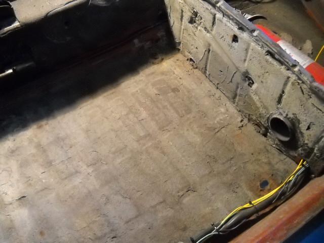

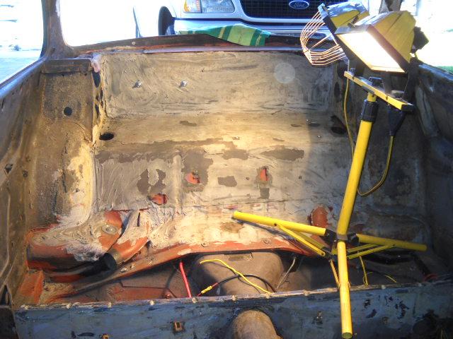

after tearing out the interior I found that the PO did a little more hacking away. Not sure why they cut out the rear shelf and they thought that smearing a sealant of some sort would quiet the interior a little.
so after grinding all of this away and actually an air chisel held at the right angle popped it right off with little or no marks to the car.

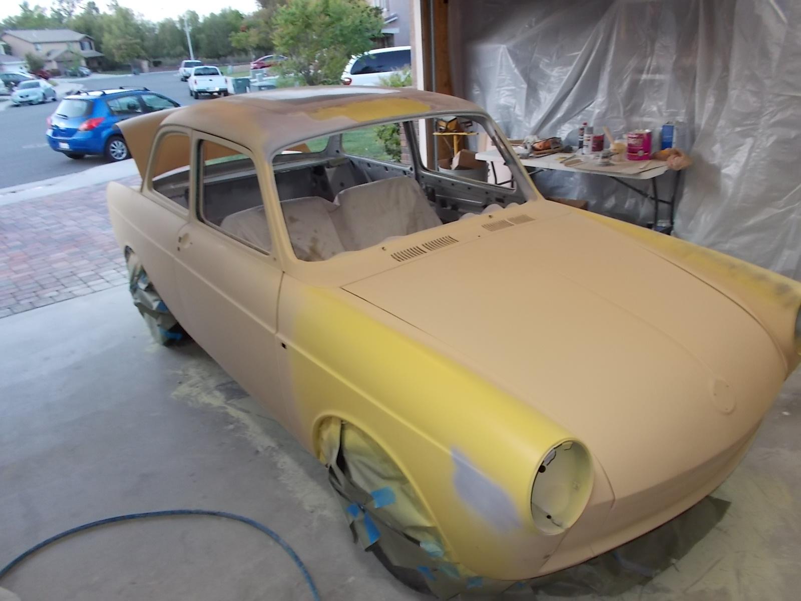

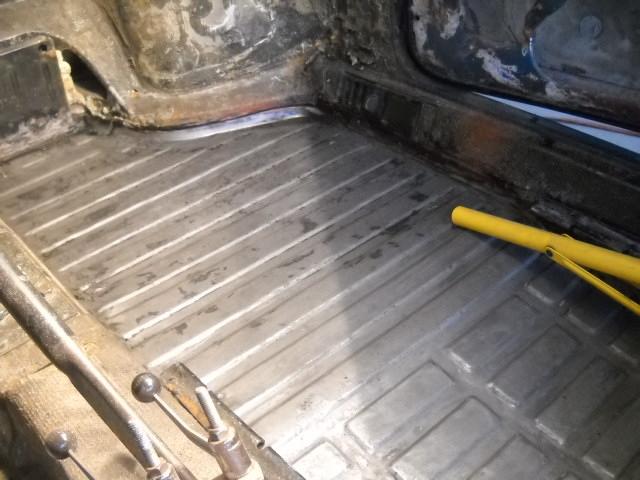

so now the entire pan was taken down to bare metal, treated with Ospho, 2 coats of Masterseries Silver and the underside of the pan 2 coats of Masterseris Black. All of the doors, front and rear hoods and all fenders were removed and sandblasted then entire car was coated with 2 coats of Masterseries Silver

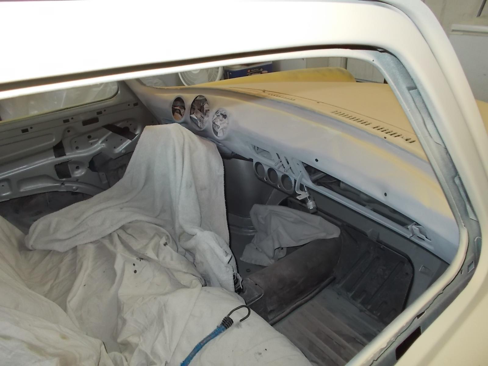

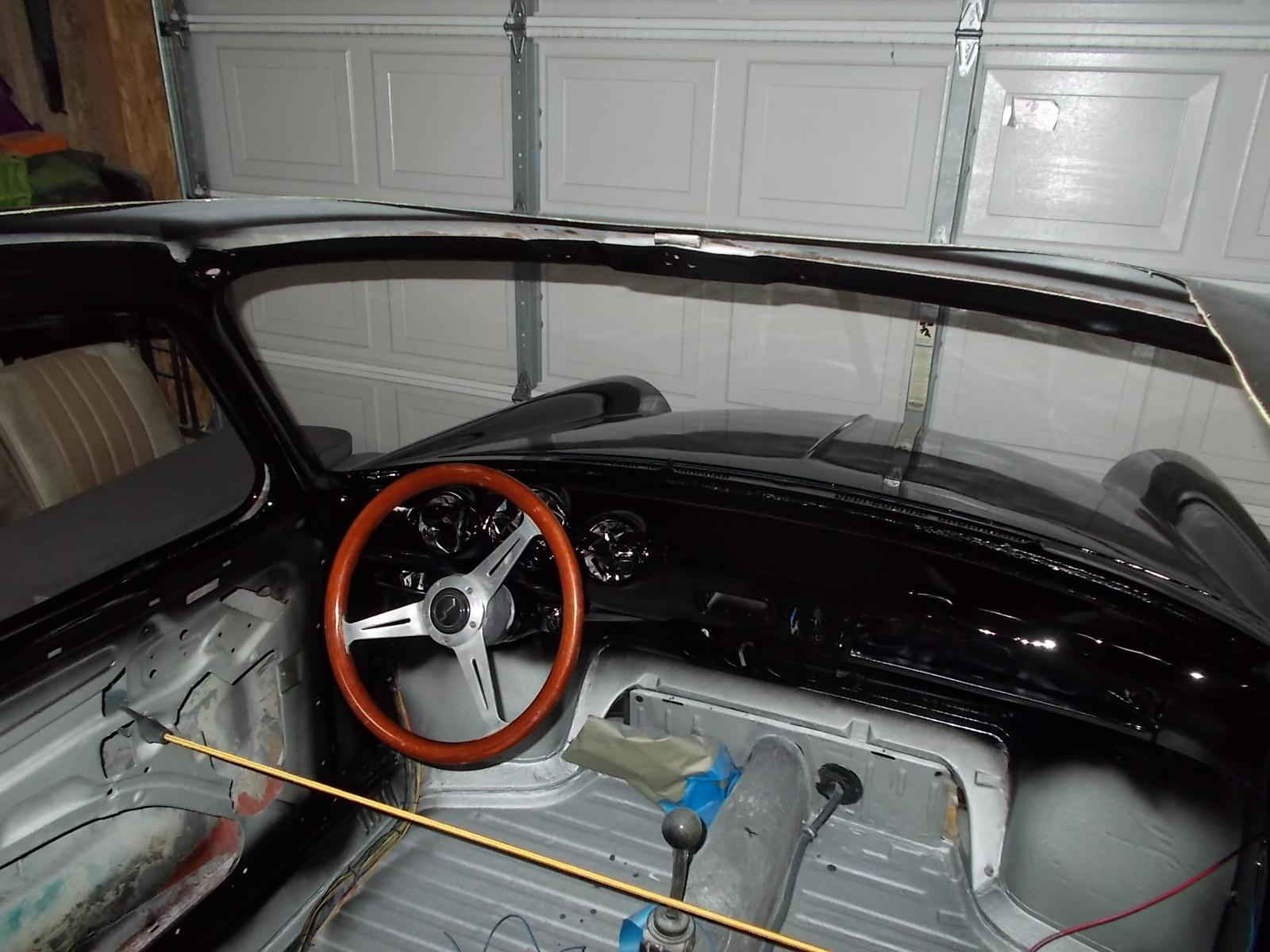

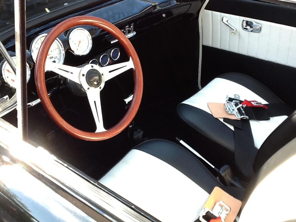

below photos of dash pad removed and holes all filled in. New Autometer gauges and the 3 blue ones in the center are Dakota Digital along with spaghetti mess of wires.

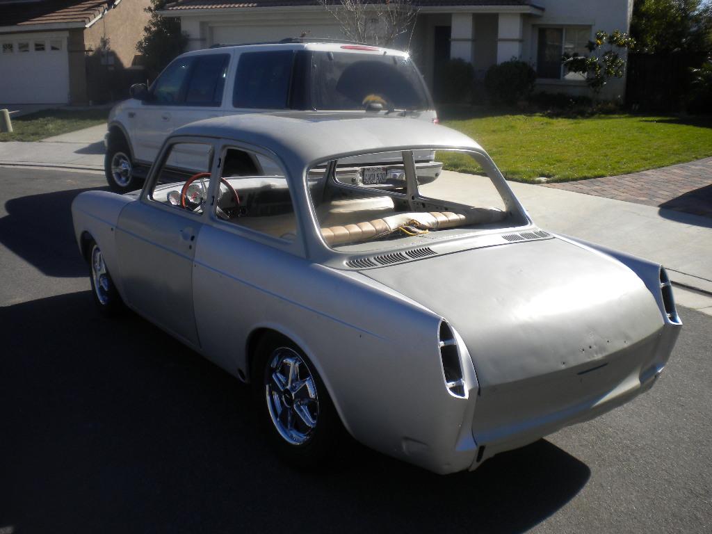

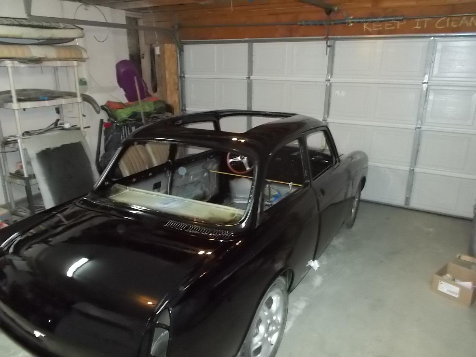

photos of car in primer and roof cut for the Hollandia ragtop.

That's a ton of work right there. Cool What is the far left gauge? Just asking as it's got 4 needles on it. Dash looks good all smoothed out like that too. Twisted Evil
Are you going to use that indent box for your sound system? I think you could get a pair of 10's back there. Wink
That's going to be a BIG sunroof in that car. Shocked

Center is speedometer, to the right of that is the tachometer; the one on the left is a multi-gauge (fuel, amperage, oil pressure, water temperature). I went with the AutoMeter Artic White so I was limited on size on what I could get. Still can't figure out where to hook up the water temperature part. The blue gauges in the lower middle are Dakota Oil Pressure, Oil Temperature and Head Temperature
Yeah, the water temp gauge might be a little out of place on an air cooled car. But the group of gauges should look really good in this car. Cool

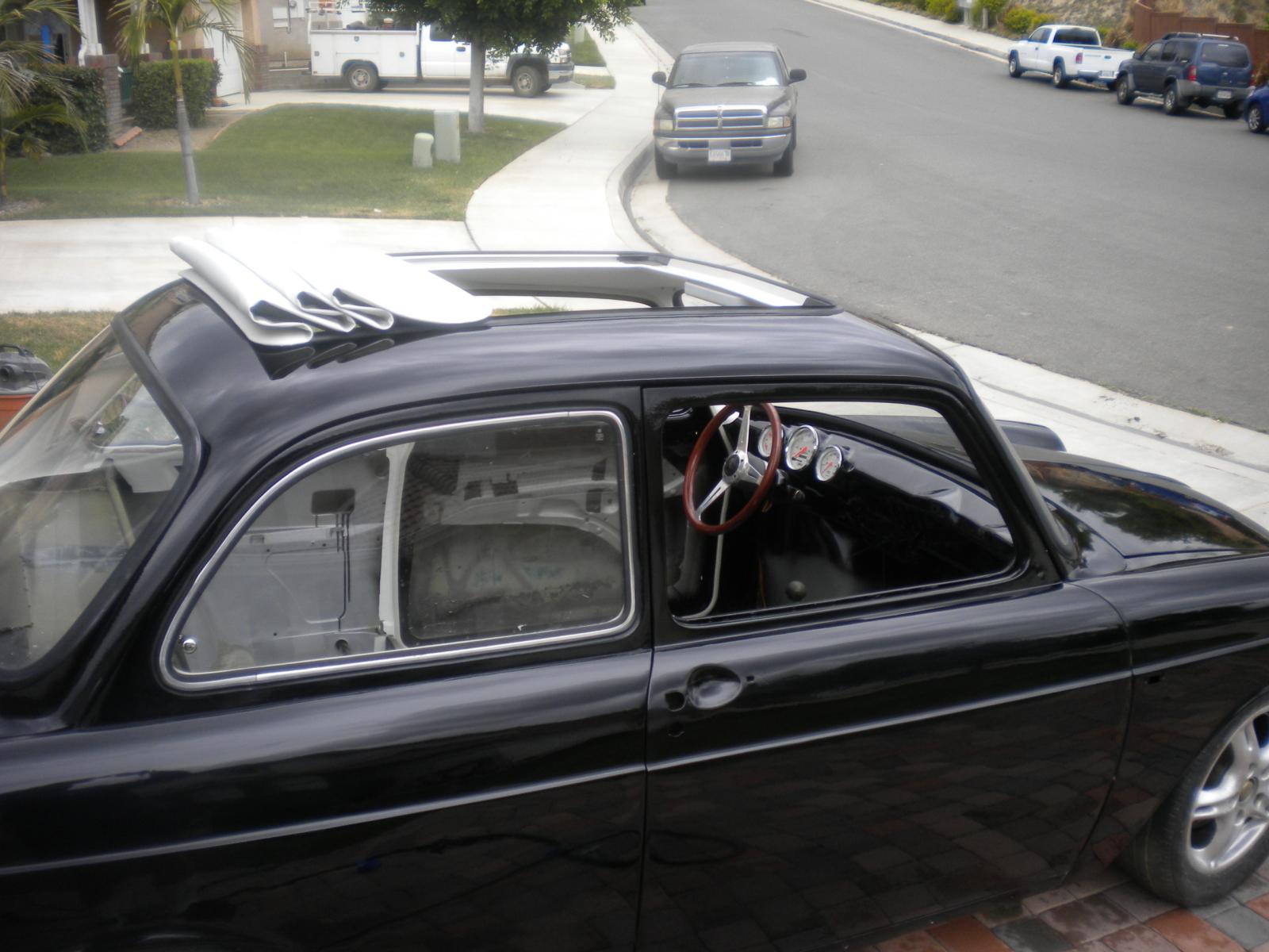

new ragtop & headliner installed along with pop-out windows. Windows were a pain in the ass. Finally found some descent tape that would hold the seal back in order to install.
next up, interior

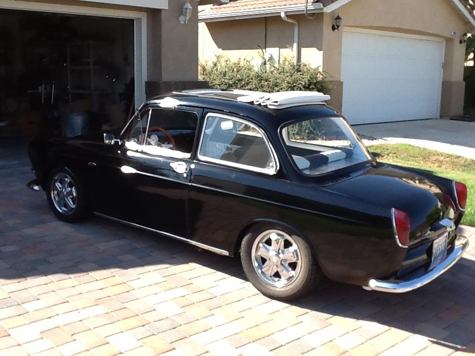

Update, Progess was slow moving during the summer. To much beer and sitting by the pool (hot temps). Got the interior installed, got the car insured and registered. 3 1/2 years and little over budget Shocked the car is mostly complete. Still need to workout some bugs here and there.
Took my 1st real drive today, head temps stayed good, oil temp got to 225 F. I would be happier with a little lower oil temps. I will continue local road and freeway tests to see where my oil temps go, hopefully not any higher. If needed I will have to enclose engine compartment.
