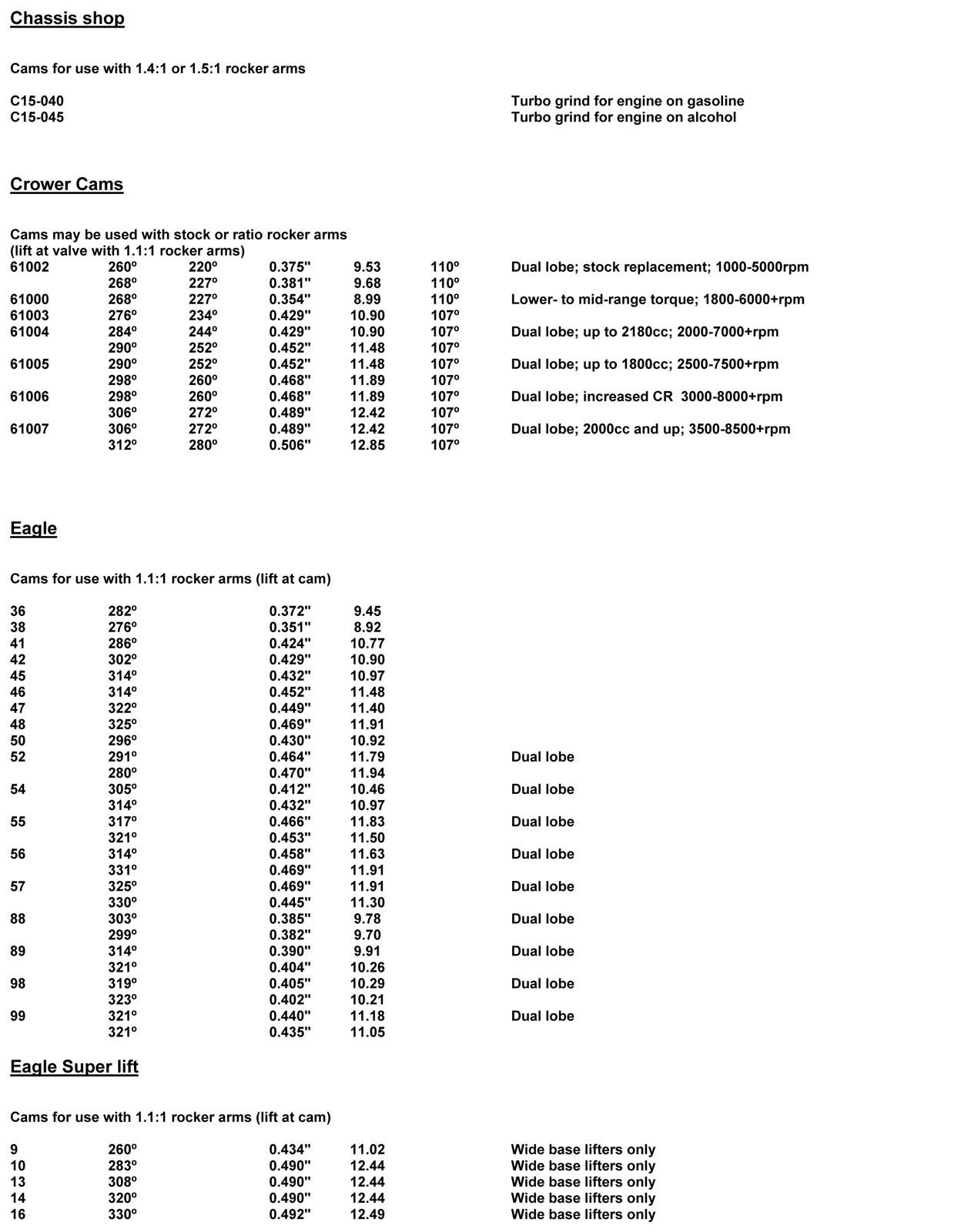

I often refer to this list for customer inquiries so thought this would be useful for others.
If you find any typographic errors or have additional specifications @ .050 please let me know and I will update the sheets ASAP.

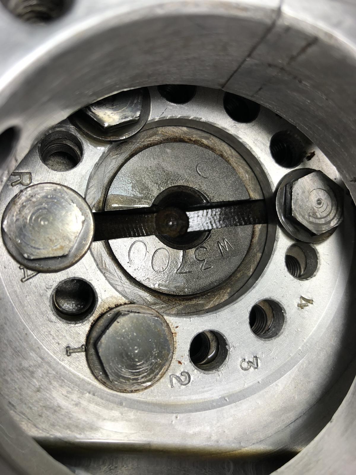

friends can help me identify these cams codes
