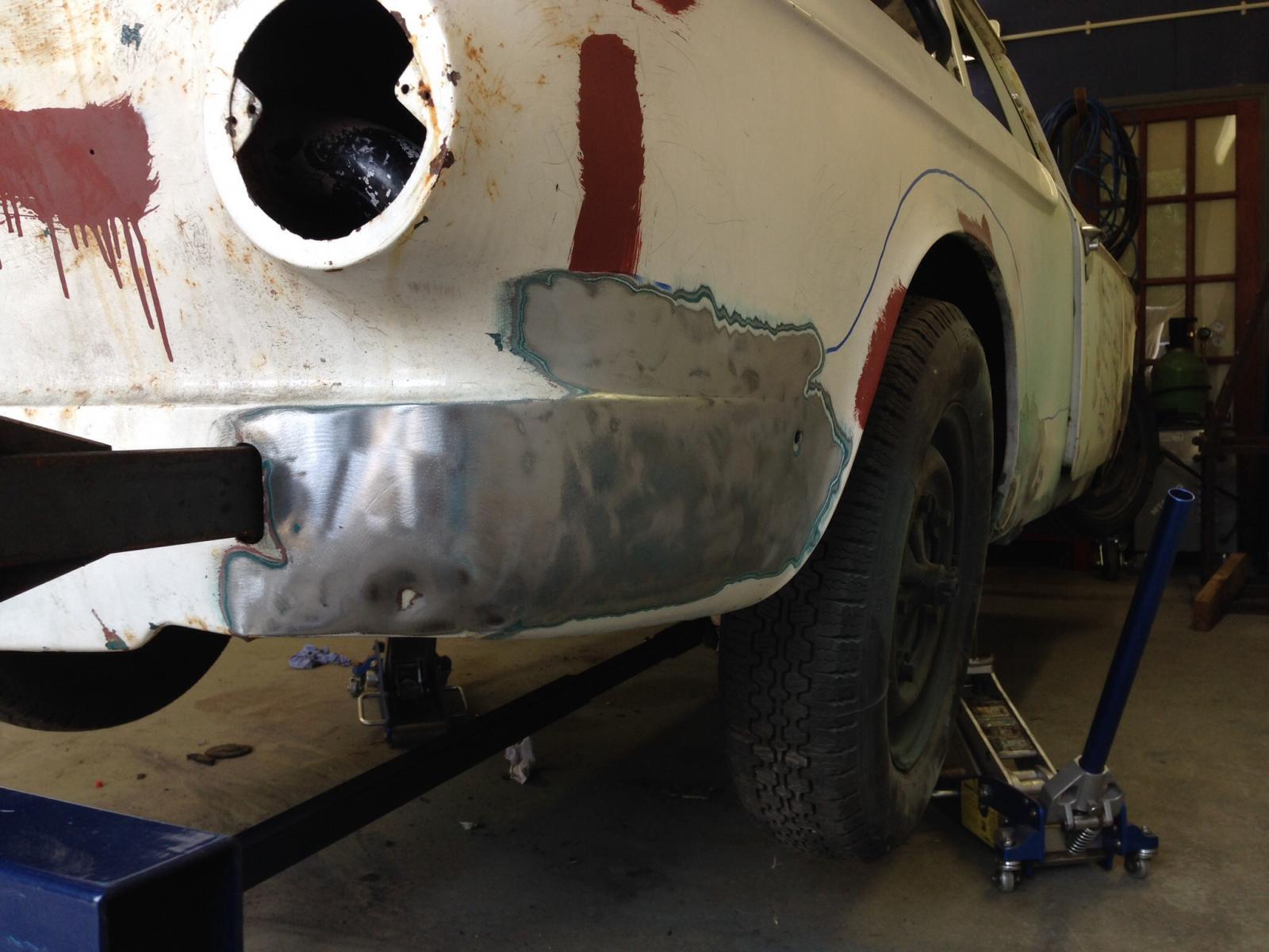

Now for the purists stop reading now, don't get me wrong I love a stock type 3 but this car was never going to be that. I got it without an engine, a fubar'd tranny and serious rust damage to one rear corner of the car.

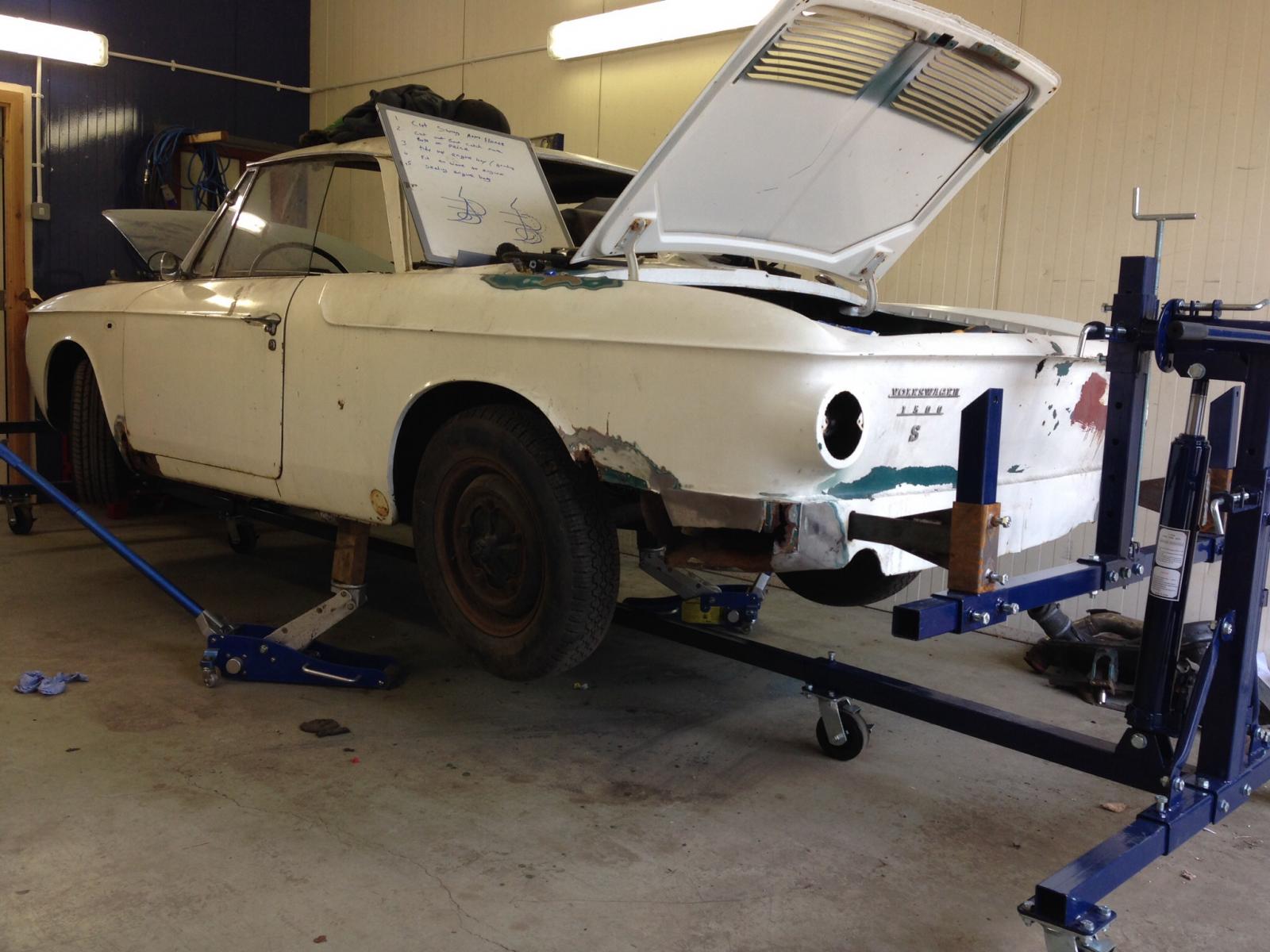

PostPosted: Sun Mar 15, 2015 4:14 pm    Post subject: Reply with quote
So this is a while back when I got my rotisserie
No Razors don't have a lot in the way of roof strength, and just starting to take the weight of the car by its bumper mounts made the doors nip up and not be able to be opened!!!

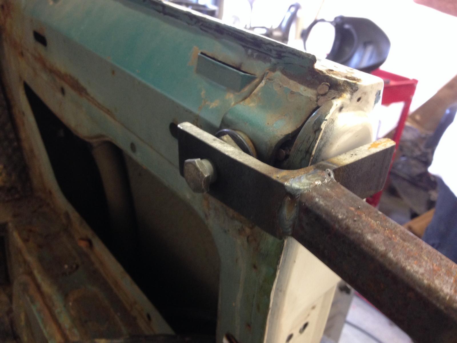

PostPosted: Sun Mar 15, 2015 5:15 pm    Post subject: Reply with quote
So to add some strength me and my cousin John built a frame.
The pan can be removed and the body is rock solid.

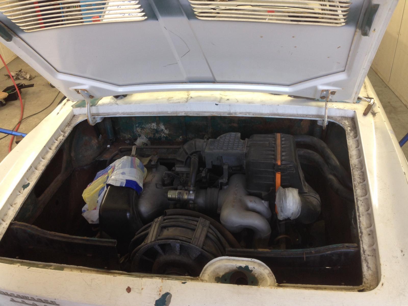

PostPosted: Sun Mar 15, 2015 6:14 pm    Post subject: Reply with quote
Well look what just squeezes under the lid!

PostPosted: Sun Mar 15, 2015 8:06 pm    Post subject: Reply with quote
That doesn't look like a type 4 Brent. Wink But, this is beginning to look very interesting. Cool

I'm going to use an IRS SB subframe, full pan, and 1303 frame head. It isn't going to be all super beetle at the front though, I've got something special in a box from San Deigo on its way across the pond. Yeah, the 915 box needs to be as far forwards as practical,

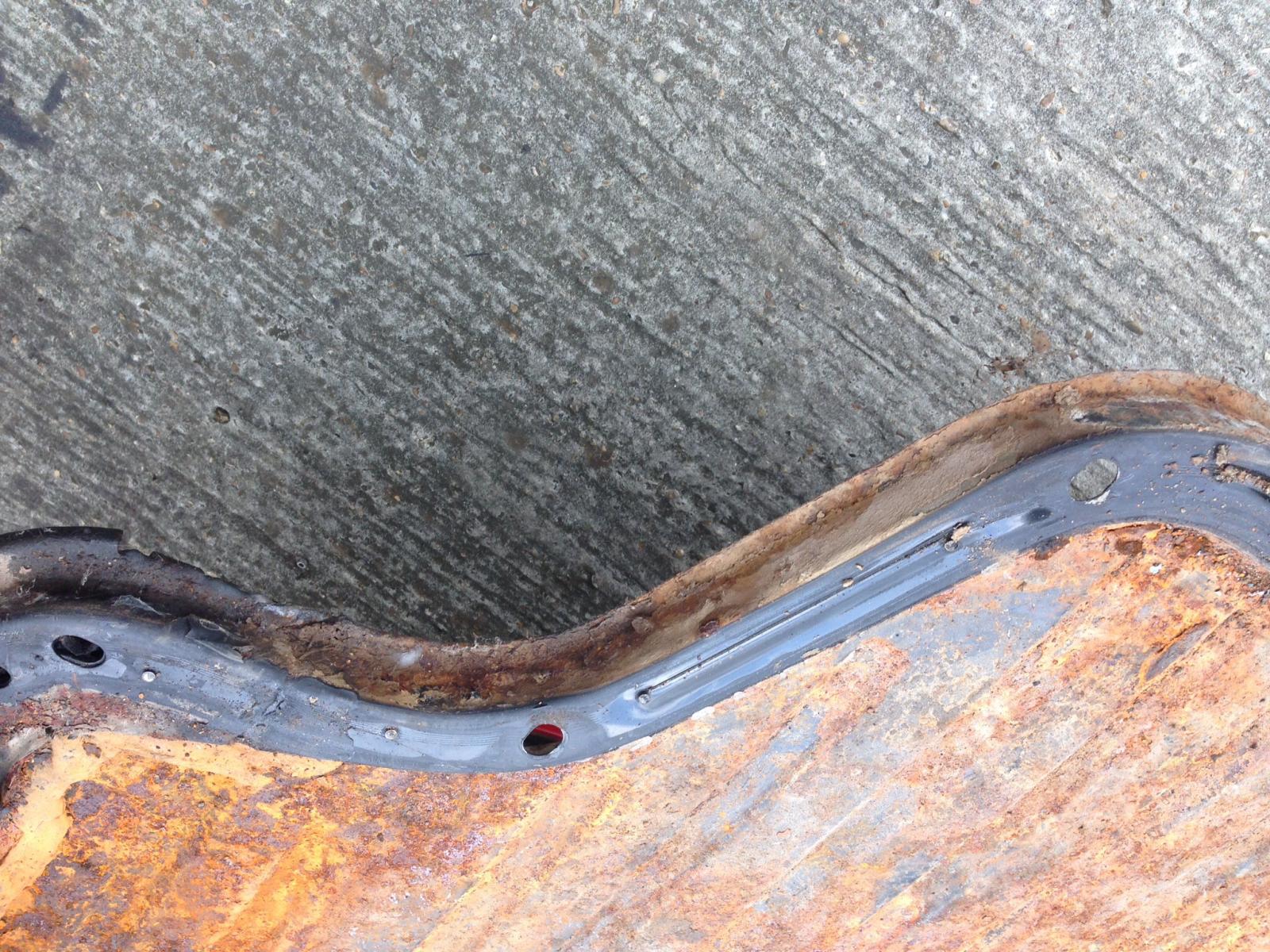

PostPosted: Mon Mar 16, 2015 2:21 pm    Post subject: Reply with quote
Now, this pan has never been off the car, and I have never seen the leading edge of one looking like this! Apart from the outer sills (rockers) and one gnarly rear corner from a botched repair and a dislodged drain hose there is very little rust.
