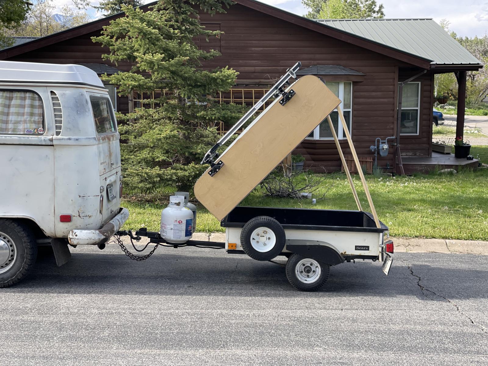

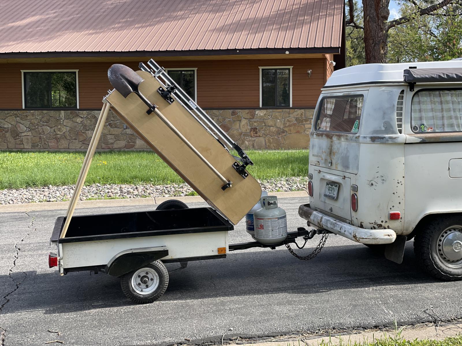

When I rebuilt my trailer, I ground out the spindles as I wanted something more up-to-date as my wheels were rotted thru and I didn't want a single mount point for the wheel. I used a 1 1/16 spindle and hub kit from the Carry-on trailer Corp brand. https://www.carry-ontrailer.com/parts/.
When I got my spindles, I test fit the hub onto the spindle and inserted the spindle on the axle (after some cleaning of the area) to get a good sense of where I wanted to the spindle to be welded in place, made my marks and tacked the spindles in place. I then removed the hubs, cleaned off the grease and took axle to a nearby welding shop to have tem use a stronger welder to ensure a deeper penetration of the weld between the spindle and axle shaft.
I order three new wheels to match the hubs https://www.easternmarine.com/8-and-10-Trailer-Tire-Rim/ and I was on my way. You can get tires from the above site as well but I opted for whitewalls to match my wagen.
Hope this helps. Best of luck

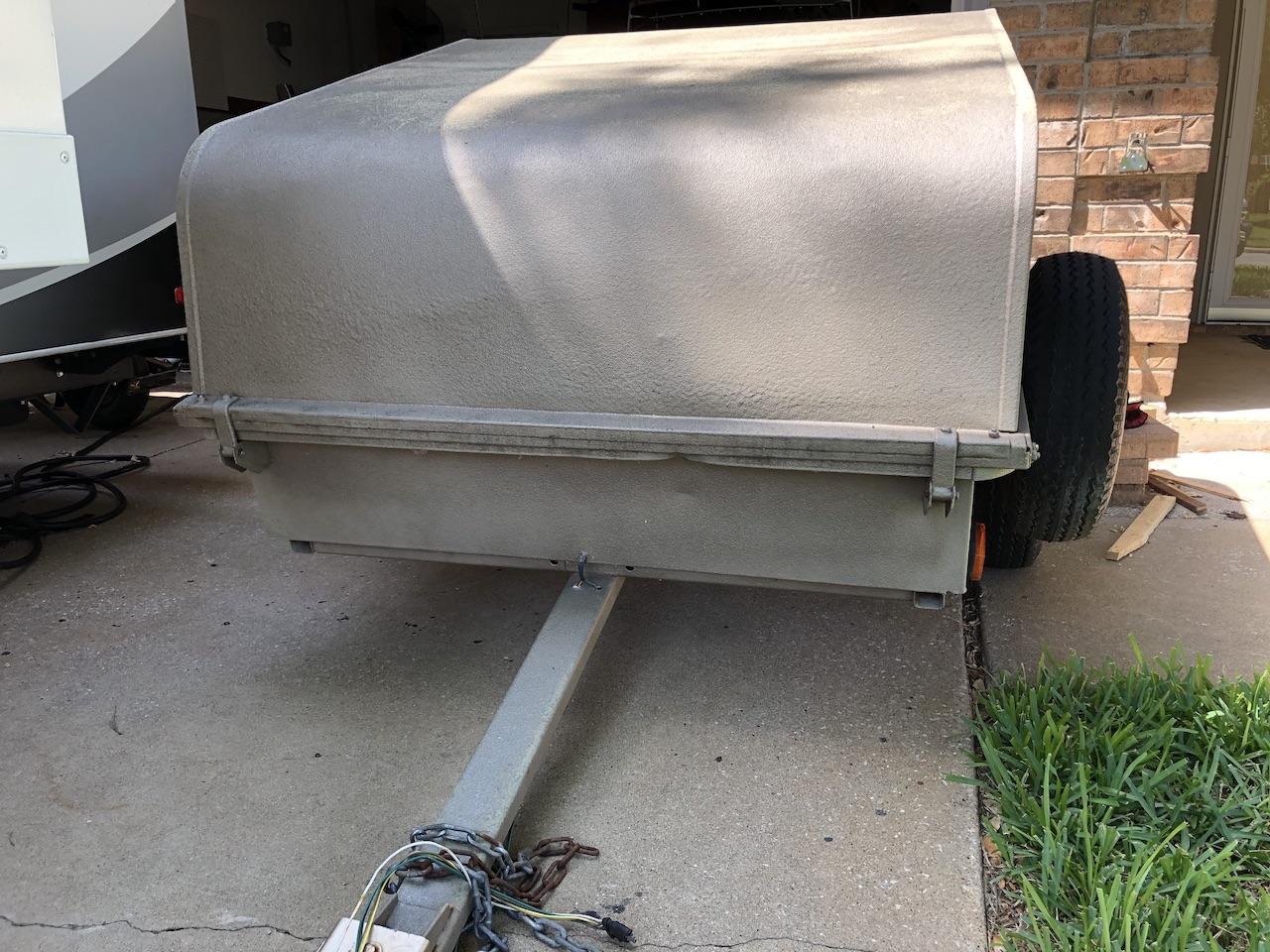

My trailer is a 1973 and I did not know its history until I sand blasted it for paint. I then saw the Sears tag on the body and did some research.
Trailer is pretty much done and updated to my specs. I wanted something that we could use while camping. I like how it turned out...
Anyway my question: Does anyone know where I can find the lid hold-opens? Right now I am using a stick, but would like to have a more secure mechanical lock.
Some pictures below. As you can see I am using much larger wheels and fenders, 2 inch coupler, new wiring/lights and a blueish/grey paint. We welded up the frame to strengthen it in anticipation of some hard off road usage. The roof racks will mount and support a large solar panel.
Thanks!
Day I brought it home
last week as shown behind my truck
Type of stuff we use it for:
Better picture:

I will admit that I am not a VW owner but as someone that has rebuilt a Sears trailer such as the ones shown in this thread. An internet search led me to this site.
I also apologize for "bumping" a older thread, but have a question or two and hoped you could steer me in the right direction.
Thanks!
Better picture:
Did a great job getting your trailer cleaned up and modernized a bit. In the lid support you could try to fabricate a set of scissor hinges like I did. Unfortunately the flat stock I used wasn’t thick enough to support the lid as my cover is once piece and a thicker gauge than the original piece so the lid weighs more...
The other solution I began to look into were lid supports much like the ones you find on modern minivans, SUV and the like.
https://www.mcmaster.com/lid-supports
I haven’t revisited my trailer as other projects sort of steered me away from it but those were the options I was exploring. Finding an OG set of Scissor hinges will be a chore. Hope this helps. Good luck!! Cool
I have essentially the same trailer but the single wheel version. I used generic gas struts (like the kind MonT3 mentioned). Check it out about 1/2 way down page 10 on this thread:
https://www.thesamba.com/vw/forum/viewtopic.php?t=...;start=180
They came with brackets to mount them, so there was no welding required. The only issue was figuring out the pressure of struts needed. That took a couple tries (it needed a higher pressure than I expected). But they were super cheap and now 2 years later, it's still working out great. We use the trailer as a camp kitchen and the lid stays up nicely with no fear of it slamming down.

Thank You! I have ordered a set of the 84 pound struts and bought the mounts locally.
Funny - my trailer bed and lid do not show any evidence of previous mounts like on CanStan's trailer. I had the entire thing blasted down to bare metal and no signs of hole filling or repairs.
I will post follow up pictures once it is complete.

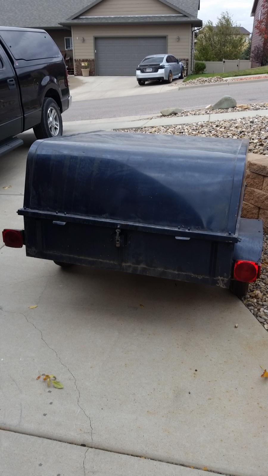

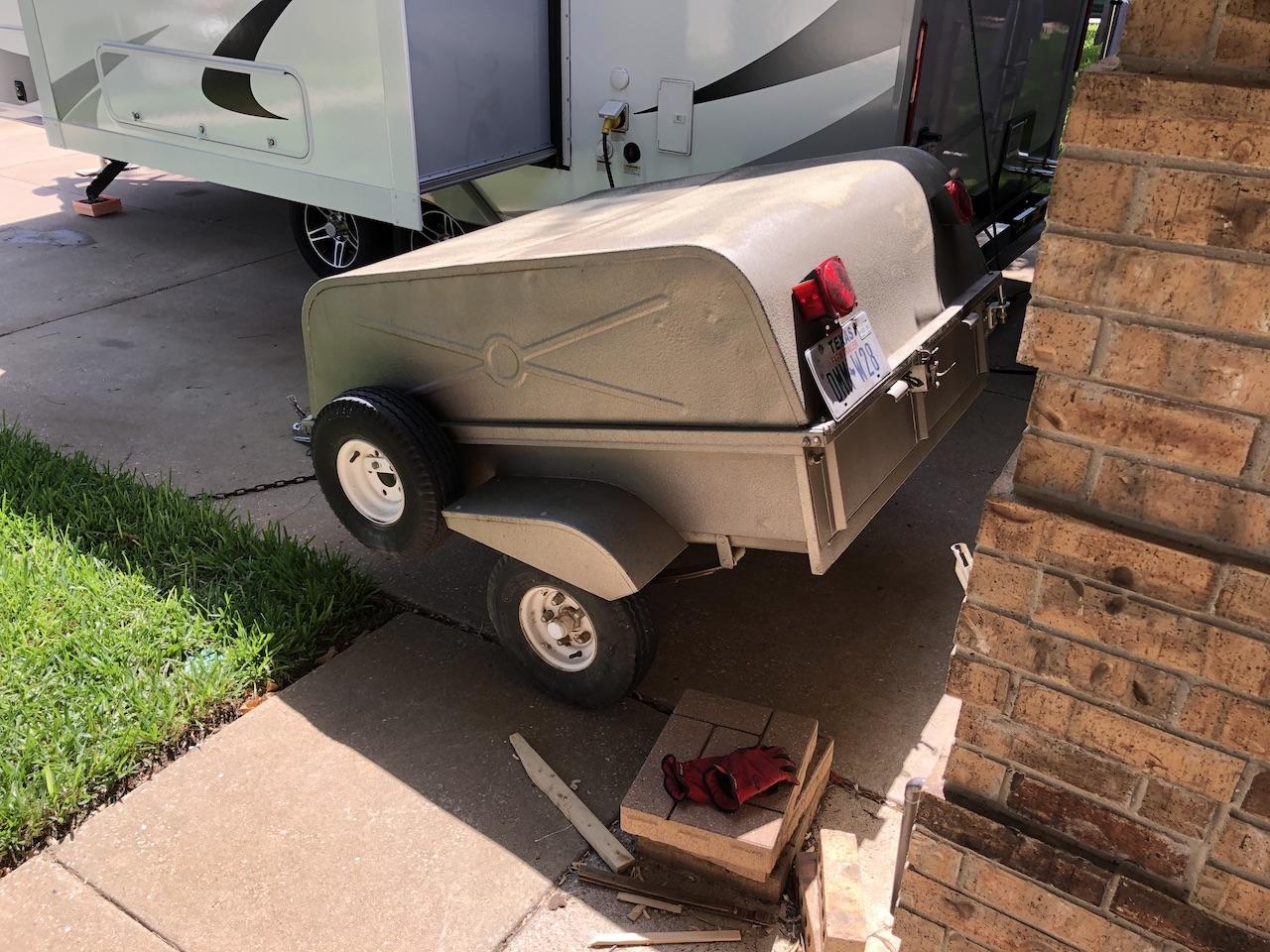

Thought I would post up the trailer I just bought for $200. It is in relatively good shape. The previous owner had LineX bedliner sprayed all over it at some time. I haven't seen the road since 2018 until I hooked it to my truck and pulled it home. I will be using it behind my Vanagon Westy TDI project to carry all the things that there just isn't room for but that you know that you need.

MonT3 is offline
PostPosted: Sat Oct 10, 2020 5:05 am    Post subject: Re: Sears allstate two wheeler. Reply with quote
Nice trailer! Looks to be in excellent shape and thanks for sharing the sears ad as well. You're going to enjoy that thing. Very Happy

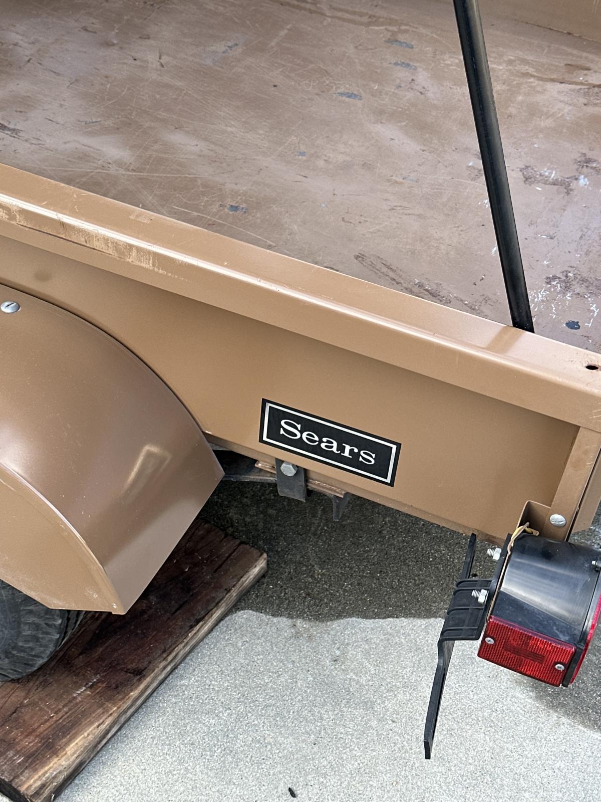

PostPosted: Tue Jan 05, 2021 6:55 pm    Post subject: Re: Sears allstate two wheeler. Reply with quote

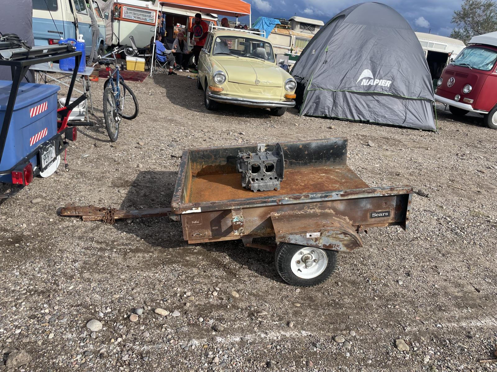

In late Nov, I happen to come across a FB add in the local classifieds page of someone local that was selling a small trailer. The lines immediately grabbed my attention but the price was eye-popping. I reached out and asked if I could come pick it up after I got off work and the owner responded back to let me know someone had beat me to it. I wrote back to thank him and let him know that if the person backs out, I can be there in a half hour after getting off work to pick it up. An hour before my shift was up, the owner reached out to let me know the initial buyer drove by their house looked at it and let the owner know it was too small for what they wanted it for. So the trailer was offered to me which excitedly I let the owner know if the wheels can hold air I'll tow it home that same evening. I met the owner and we chatted for a bit. He let me know it had some electrical issues on one side and I let him know that was too easy to fix. He asked if I was serious about the trailer. I pulled out my phone and showed him I had an earlier one which I rebuilt. He smiled and and mentioned I think it's going to a good home. He went to tell me his father bought it new from the local Sears and it had been in the family it's whole life. After his fathers passing he took it and over time painted it to match an Explored they had and used it to travel across the country. After that, it was rolled under their deck where it sat for the remainder of it's time till the man said he was selling his house to downsize (kids all moved away). So he pulled it out, aired the tire and posted it up for sale. He went inside to get the title and brought his wife out to meet me as well as look at pics of the trailer I built as she couldn't believe someone else had one. The title was signed over, $200 exchanged hands and hitched it up to my truck, plugged the light plug into my hitch and off I went...
This trailer has the bars to hold the clamshell top open as well as handles to open the top. My 68 doesn't have that. Either way, I'm happy with my new addition.

PostPosted: Sat May 27, 2023 4:20 pm    Post subject: Re: Sears allstate two wheeler. Reply with quote
Here’s my recently completed 1973 Allstate. I won it in the raffle at Buses and Balloons in Albuquerque in 2022.
Before
After

PostPosted: Wed Sep 27, 2023 10:44 am    Post subject: Re: Sears allstate two wheeler. Reply with quote
Picked up this 1975 Sears trailer.
This was probably in storage since 2000. It came with the accessory trailer stand wheel. It has what I believe to be the original Goodyear tires. I rewired it and bought some new tires.
Questions, what do you guys think the holes in the fenders are for? Looks like a good spot to mount a fender marker pole or side marker light.
This trailer did not come with a lid prop. In the photos I am using a child cot rod. What did this era trailer originally come with in terms of a lid prop?
