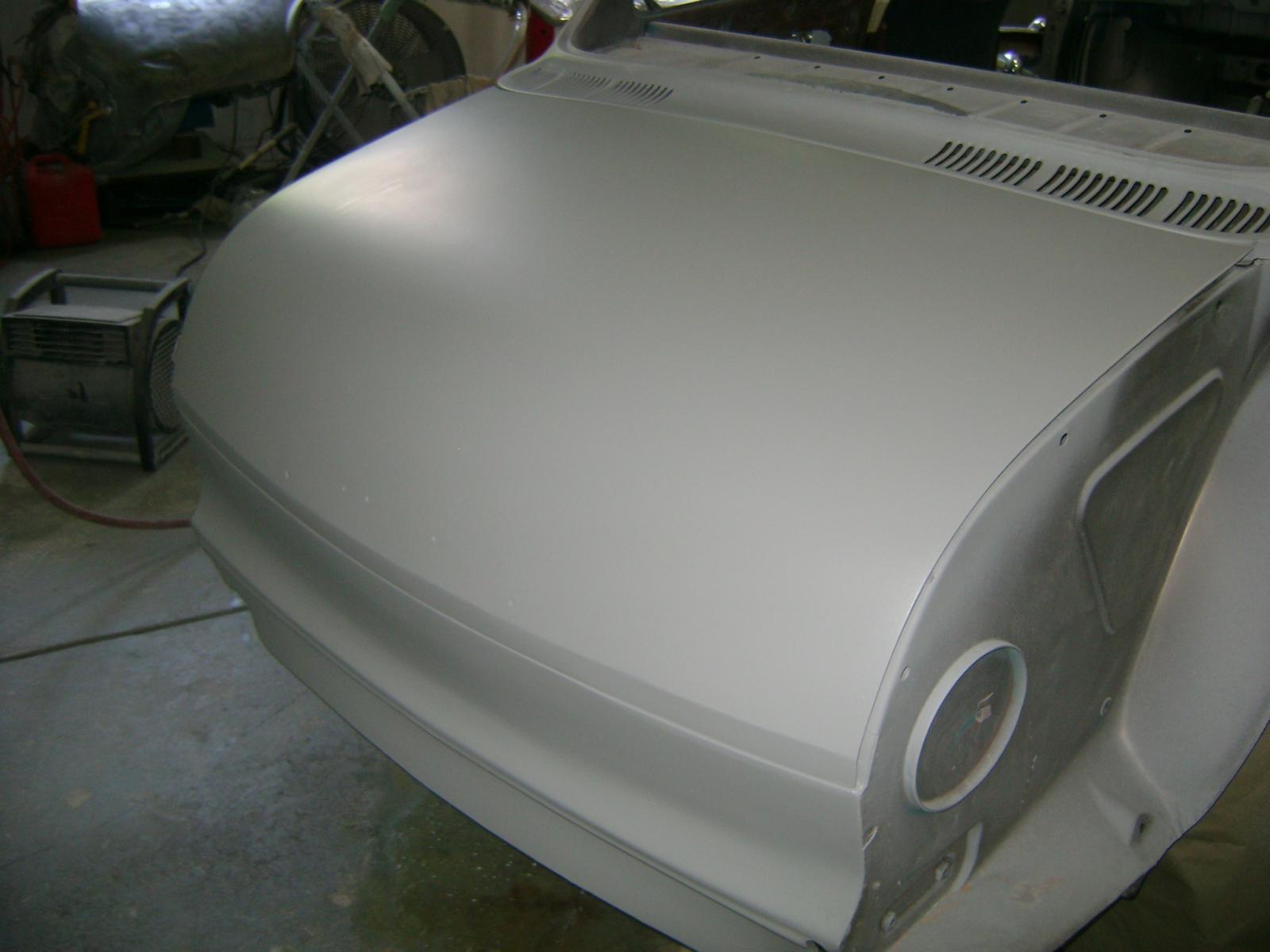

suruba wrote:
wow that looks great!
did you decide to make the rear apron smooth? or is the white swallowing the contours of it?
Dave
Ahhhhh - the rear apron dilema. So here's what we had to work with:
After unsuccessfully trying to source an apron in the classifieds, and ruling out a fiberglass replacement, I decided to forgo the aesthetic & aerodynamic Very Happy properties of the ridged apron and smoothed it out. Since it is largely covered by the bumper, I thought it was a fair compromise to make.
Here it is in blocking:
And finished paint:
Overall - I'm pleased with how it came out, given where we started.

so do you do the body work and paint yourself?
I've got an apron similar to your condition, pre-smoothing and it is so hard to get straight. I'm thinking of drilling out the spot welds and trying to straighten it out on a bench with more room to work the metal

PostPosted: Thu Aug 08, 2013 8:17 am    Post subject: Apron Reply with quote
Dave
I do not - paint and body work, as well as machining get farmed out. I usually try to work with cars that don't need paint work - but I ended up having to do it on this project to get the result that I want for the car. If you check the photo stream, there are many shots of the rear apron in progress, as it and the rear deck lid were the areas with the most damage. I know that my paint and body guy worked several days to get it where it is.

PostPosted: Fri Aug 09, 2013 4:08 am    Post subject: Reply with quote
My apron was in about the same shape. No way would it have ever looked right. So I had the body shop smooth it out. I kind of think it looks better anyway...
