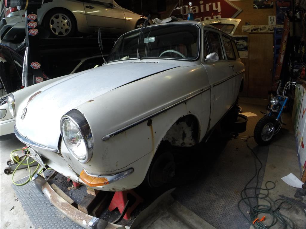

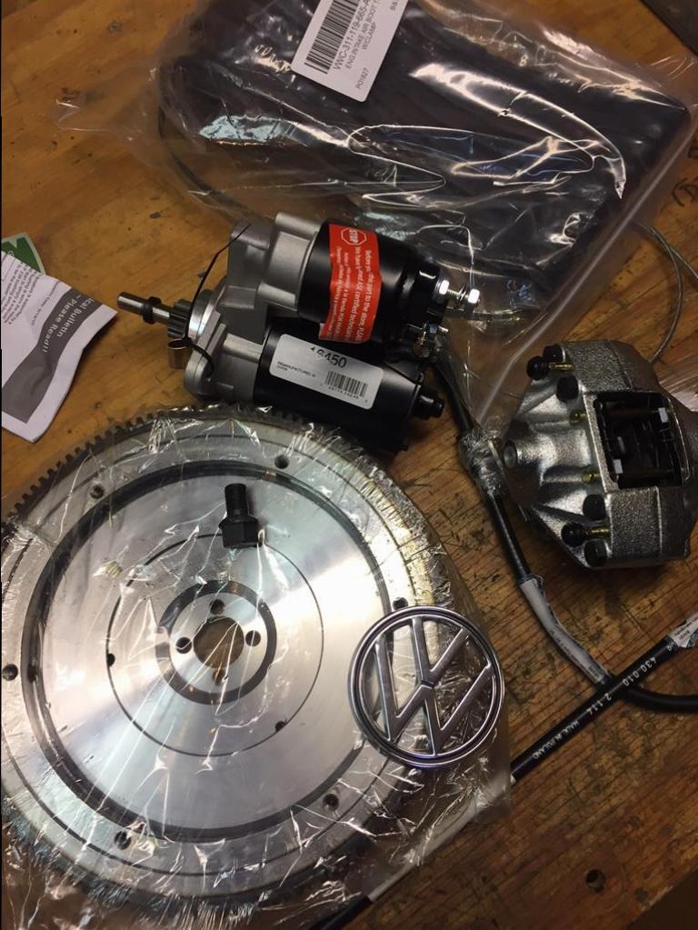

That looks like a great starter project for someone "getting their feet wet" in a restoration. Some of the parts might be a little harder to find here in the "salt belt" than others, but the parts are out there, you just have to track them down.
At this point in your resto, you might want to re-think changing the 6 volt starter and flywheel, unless you plan on changing the crank, and grinding out the bellhousing of the trans. It's a lot more work than you think, unless you're building a new engine for it. The 6 volt starter will handle 12 volts, but it turns the engine over faster. Also, some of the 6 to 12 volt starter bushings are made of softer metal than they should be, which can cause a problem down the road (BTDT, replaced it again).

Bob, re 6v 12v, The car sort of came to me with not many details, so I'm doing some automotive archeology. The car came to me sans starter, with a 12v alternator in place and 12v bulbs in the sockets. She's been in storage at least 15 years and there was only 1 of 4 bolts holding the engine in, no cables connected, partial brake assemblies and I can't get the engine to rotate 360 by hand. It really is calling out for a total rebuild, if not very close. The flywheel is chewed pretty good. So if I need a flywheel, starter, and have 12v alternators and bulbs I don't see much chance of going back to 6v. The plate where the engine ID stuff is supposed to be looks blank to me, I really don't know what I have here for an engine.
I saw a video about getting the correct 12 v brass starter bushing in the case to fit the 12v starter, is this why you mention the case needs machined for a 12v starter?

To Bob's point - you don't need to change the flywheel and, then, change a lot of other related parts to convert to 12 volt.
I converted my 64 to 12 volt without changing the flywheel/modifying the bellhousing, etc. I got a 12 volt starter with teeth for the 6 volt flywheel. They're about $200 if you get a high torque IMI starter. I don't have to turn the key and hold it - just turn the key enough to engage the switch and the car turns over.
Putting 12 volts on the 6 volt starter will gradually eat the edges of the flywheel because the solenoid begins turning before engaging the gear ring.
Yes, Bob is correct.

start with the body and chassis before you get into the mechanical. make sure you have dents removed to your content and paint put on everywhere you want it before you get ahead of yourself. looks like my squareback but with a little more surface rust. I dont really know how to do floor pans on these but I'm almost sure it will be extremely difficult. Maybe patching the pans would have been your best bet. rip out the old spades on your harness and put new ones on they, are most certainly corroded and brittle, in the case that you are saving the og harness, it will save you time when one fails causing a short later. I did my car ass backwards doing all these things in reverse and regret it. I got away with it because the car was for the most part in overall decent condition. I only mention this because short of a few small managable mechanical issues, rust is the main issue with maintaning the concept of keeping this car until the day you die, which is possible with a decnt paint job and a garage. Welcome you have quite a job ahead, good luck.

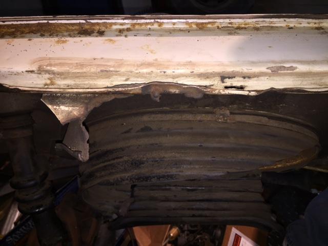

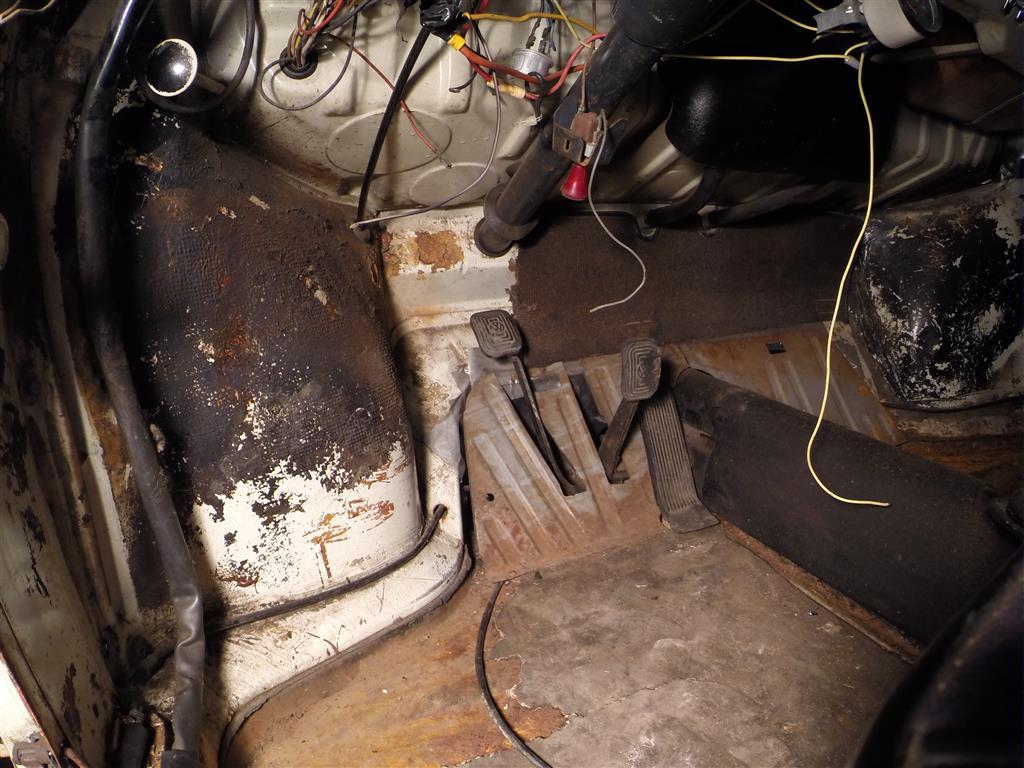

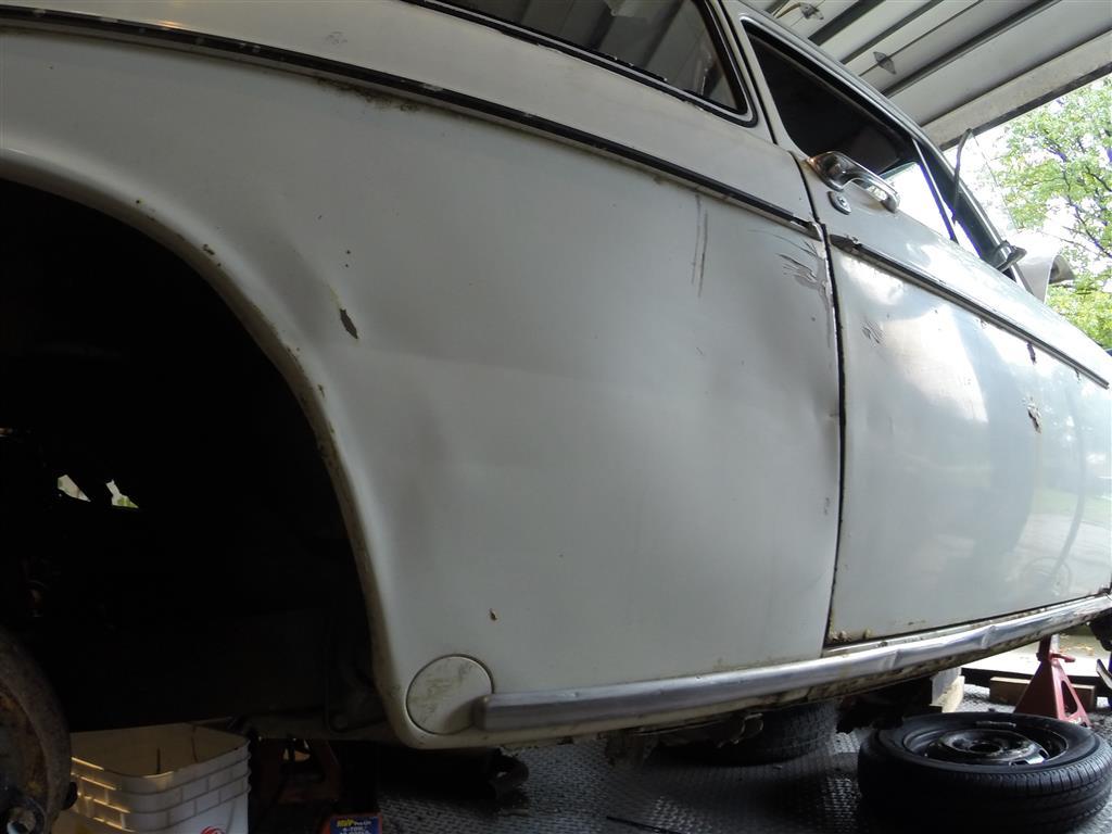

Hello guys and thanks for all the feedback. I've got some updates and some pics to share. I've been taking the engine apart to see what I've got and cleaning some parts up. The pushrod tubes leaked a bunch and made big clumps underneath, there were a couple of mouse nests in the plumbing but all seems well. The engine now rotates freely, the flywheel is all chewed up, 12v starter at work perhaps??
I would like to have found some numbers on that pad by the fuel pump but ??
At the momont I'm unable to remove this big blower housing, it seems the alignment pins are stuck, but I've been PB blasting them
I fear that I am missing my rear motor mount or 'stabilizer'. Here is a pic looking down at the rear bellows area and it looks like that whole rear mount is gone. I've got an ace welder guy ready to put the floor pans in, shall I source or fabricate a new rear mount for this mighty 1600?

You could buy or fabricate a rear stabilizer mount if you buy the steel/rubber stabilizer to bolt onto it. I personally think it is overkill unless you are gonna "road race" your 54 horse power 1600 & could be eliminated? You could buy "How to Rebuild Your Volkswagen Air-Cooled Engine" by Tom Wilson as an engine guide. You should pull all 4 fenders to get started on the bodywork as it will take longer than the engine. You can ship fenders etc wrapped on Greyhound. Keep the updates & pictures coming! Cool

When I was looking at your pics, my initial thoughts turned towards the tappage in the rear area.
A good guess as to where your rear mount went; it was a victim of the accident.
They likely had to sacrifice it in order to remove the motor.
If that were my project (take that FWIW),
My focus would be on getting the rear of the car straight.
Once you have the rear fenders off, the extent of the damage will be revealed.
IMHO, the best strategy would be to pull the apron off, based upon what I can see from here.
(I have a decent used apron if you need one)
It would also be worth it to set the whole rear mount right, and use the motor and mount parts in place to get everything re-aligned.
Again, my opinion..
The fit of the rear fenders and rear hatch being off -might- have exacerbated the damage by allowing rust to form, depending upon how long it was there, and how long it sat outside?
You are going to want that rear hatch to seal perfectly to keep from getting fumed out by exhaust.
Dang, if I didn't cut that very same rear mount and bracket off during the butchery of my own car, too... I'll see if I can't find it around here somewhere...
Anyhow, the rear apron/compartment/ductwork area of these cars is quite involved, and prone to rust issues.
Once you get that sorted, all the rest of the car will be easy.
If you can stand t dig thru 70 pages of drivel, I did the apron replacement on my car, and took a bunch of pics..

I used a 6 volt starter daily for 16 years on my 12 volt 66 Bug and it didn't eat up the ring gear teeth. Don't worry too much about that if you decide to go that route. Just make sure you replace the starter bushing in the transmission case.
I agree with Clatter, it looks like the car has been hit in the back. It can surely be fixed, but it'll take time. That's where the blue Bentley manual will really help, as it has dimensions do body measurements.

LOL- The Jbugs catalog just came in the box with the new flywheel, but it has a lot of squareback stuff in it. Most importantly the interior goodies. I need to dream of a finished interior someday to encourage myself to work thru the tough parts like the hit in the rear end and the floors
The old flywheel was chewed up, maybe from a 6v starter and a 6v flywheel running on 12v, who knows but the new one is here.
Christmas morning for an old dude, new parts are all very sweet! here is starter (with new bushing) flywheel, a caliper and some rear brake cables. I love getting boxes with new car parts!

That car actually doesn't look as crusty in the cracks as it might have been looking at the outside..!
