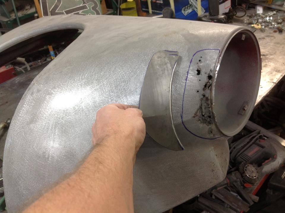

The body shop continues to plug away at the body. They get the rusty areas repaired. Including cutting out and replacing a large section to the trunk deck.
And dealing with the rust on the front passenger fender under the headlight bucket.

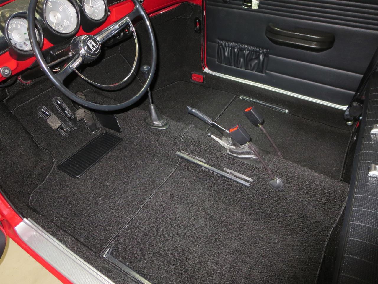

I get the headliner in. Not perfect but a good learning experience. Samba threads helped here.
I replace the complete wiring harness (from ISP). I’m good with electrical but it is still a pain when you’re using old relays, switches, and such. Wiring diagrams on the Samba help and ISP provides good information. I buy a new fuse box from EIS Parts. It is not correct and needs modification to work. I also clean up and repair the instruments. And get all the electrical functional.
In the process of getting all the wiring harness in I am doing the final install of the fenders. I really struggled with the driver side rear. The seals from ISP are excellent reproductions. But what I learned was you really need the one that goes around the wheel well to be really soft when you put the fender on. Or it won’t bend like it needs too and you will be fighting to get the fender on.
I get the dash from Retrovan (Herman) and get that installed. Originally I installed it without the black rings that are embedded in the original dash. Don’t do that or you can’t get the gauges back out once installed.

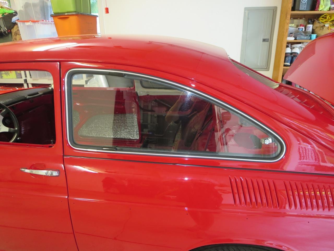

Next I install the glass. I get all the seals from ISP. Pop-outs first. Thanks Brent for the awesome pics and tips. Only thing I learned was don’t use silicone to put the glass in the rubber seal. It is better for the seal to be grabbing the glass and keeping it in the correct shape.
Front window goes in easy. Back was a PITA. I think I needed some sort of lubricant between the seal and the body. Got it in but it is not really in completely. I was hoping it would settle over time but I might have to redo it.
Door glass is definitely not a lot of fun. Brent has some great information in his build thread.

I finish the interior. All TMI stuff. I stayed original to what the car came with (Black Leatherette). I install a reproduction steering wheel (Airhead), modern seatbelts (EMPI), and add some Coco mats (Cocomats.com).

And here is the final product ...
