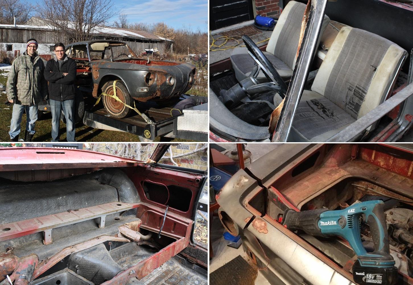

December arrived and I got a call from my good friend Jack Fisher. He had a few days available before the New Year to retrieve the T34 in Arizona. I had not told my wife about buying the T34 so I told her that I would be driving to Tucson for work. My other good friend Pedro Sainz volunteered his F150 truck & was able to borrow his friends dual-axle trailer. The timing was right and Jack & I left on 27 Dec for the 6-hour drive to Tucson.
When we arrived Timothy & Trey were there but Tim was at work. We first loaded the body shell onto the trailer with just the four of us. Not an easy task, as the steel body with doors attached is HEAVY! After moving it 5 feet at a time we finally got it onto the trailer. We lifted the body & slid the chassis underneath. By that time it was getting dark & Tim came home, so we washed-up and headed off to dinner. Tim shared his memories about buying the T34 and Trey shared that he had traded his Beetle Cabrio for the early-62 T34 Coupe in their collection.
The next morning we arrived early and collected as many T34 parts as we could find, sharing them amongst the two 1962 T34s. Hoods, glass, lights, pads, and other bits were discovered & loaded into the truck bed. I'd agreed to buy the engine from Tim's 1963 T34 so that was loaded as well. Jack & I drove back to San Diego that morning, tired but excited.
I'd arranged to have my old friend Kevin Zagar fabricate a steel tube body cart, so we arrived at CoolRydes in the afternoon. We watched with amazement as Kevin cut steel tubes and welded them into a unique T34 body cart. He mounted straps to the T34 windshield posts to lift the T34 off the trailer and make exact measurements to use the existing body holes. By 7pm he'd loaded the body/cart back onto the trailer and we headed over to get Pedro who would help get it off the trailer at my workshop. I'd already arranged with five other friends to help carry my RHD 1965 T34 from the garage into the workshop that evening. With everyone's help we got both T34s carried into the workshop. My wife was shocked that I'd bought another T34.
