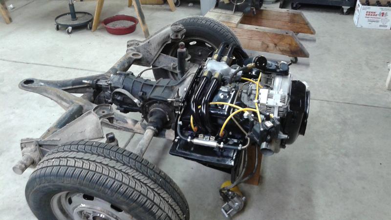

This is the fresh engine going into my 67 fasty. The tranny came from my previous DD, a 68 square.
This time I'm going to try removing the old tranny / engine from the car assembled and then reverse the process with the fresh stuff.

My removal plan is to unhook the subframe, lift the car then roll the old sf/tranny/engine assembly, on its own wheels, out from under the raised car.
Installation of the new stuff is just the reverse.
The center of mass is only a little aft of the axle. Moving it is easily a one-person no jack effort. Put the transmission in neutral and move it around like a wheelbarrow.

I think the whole assembly will tend to tilt backwards. Wont it be dangerous?

In my picture you can just see a piece of 4x4 wood under the engine. That will keep it from tilting much as the car goes up. And the front wheels will stay on the ground.

I can confirm with Max that the entire assembly isn't too heavy on the engine side with the subframe assembly as he showed. I wheeled mine around without a problem. However, I did not install my assembly like Max plans to do. I just stored mine like that for a little bit. I was fortunate enough to have the body off the pan to attach everything first before putting the body on.

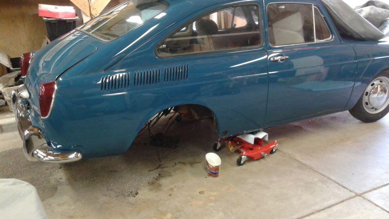

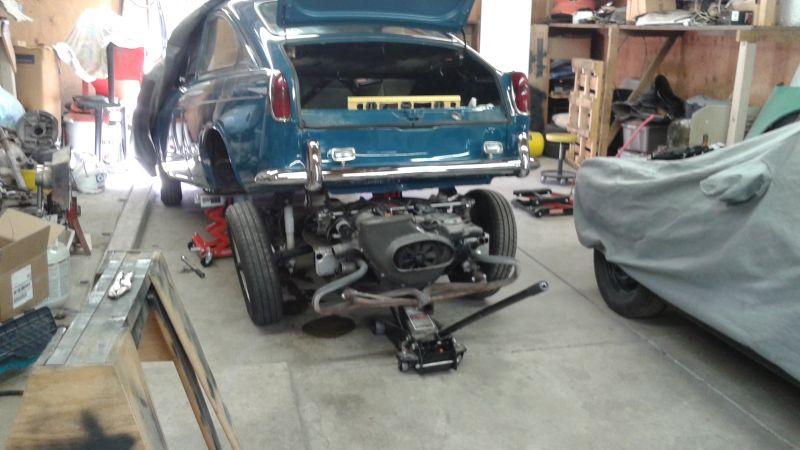

Extraction completed.
To lift the car, I used a pair of 450 lb transmission jacks, one under each jack point. I was a little worried about the weight but figured lifting only the rear of the car without the engine/transmission/subframe should come in under 900 lbs. Since it worked it either was less than 900 lbs or I got away with it.
Here is my process.
Remove battery.
Jack the car up by the s/f with an ordinary floor jack. Take the wheels and the (split) rear brake drums off. Because type-3. Wink
Unhook everything underneath.
I moved front to back, starting with the forward s/f pad (get all FIVE bolts), the brake hardlines, emergency brake cables, backup switch plug, clutch cable, bowden tube, shift coupler, heat control cables and tubes. Disconnect the fuel line and either clamp or drain. I clamped. Bad choice. Open all windows. Apply kitty litter.
Now put the wheels back on and lower the car.

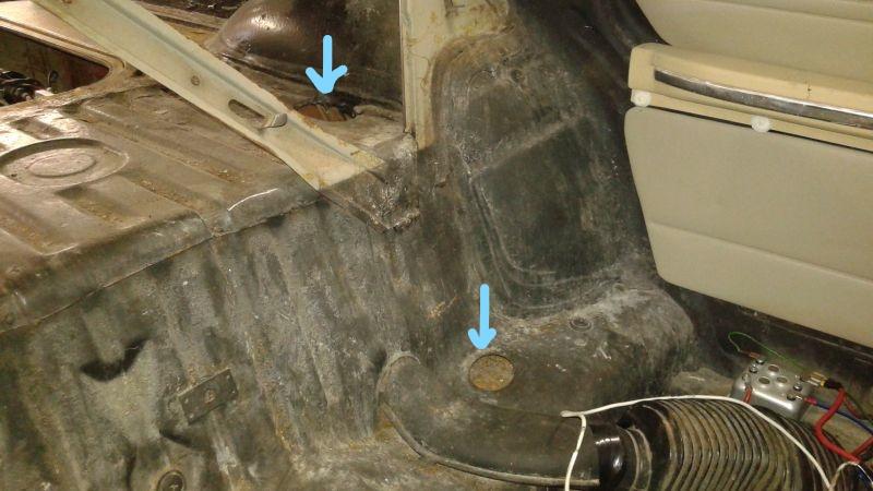

Topside I started inside the car and buzzed out the four s/f to body bolts.
In the engine bay I disconnected the ignition, throttle cable, anti-torque brace (swing axle). Don't forget to remove the dipstick. And the engine-to-body boot. Ahem.
Don't worry too much about having left something connected. Anything you forgot will make you pay, perhaps involve a replacement search and generally prevent a happy ending. Wink
Place the floor jack just under the engine. As the car lifts off, the engine will tilt down. The jack will catch the engine.
Start jacking, a little on each side, keeping the car reasonably level and checking for hangups.
That happy ending looks like this.
The car may now be easily moved around the garage on the wheeled transmission jacks for further depot level maintenance.
Max
