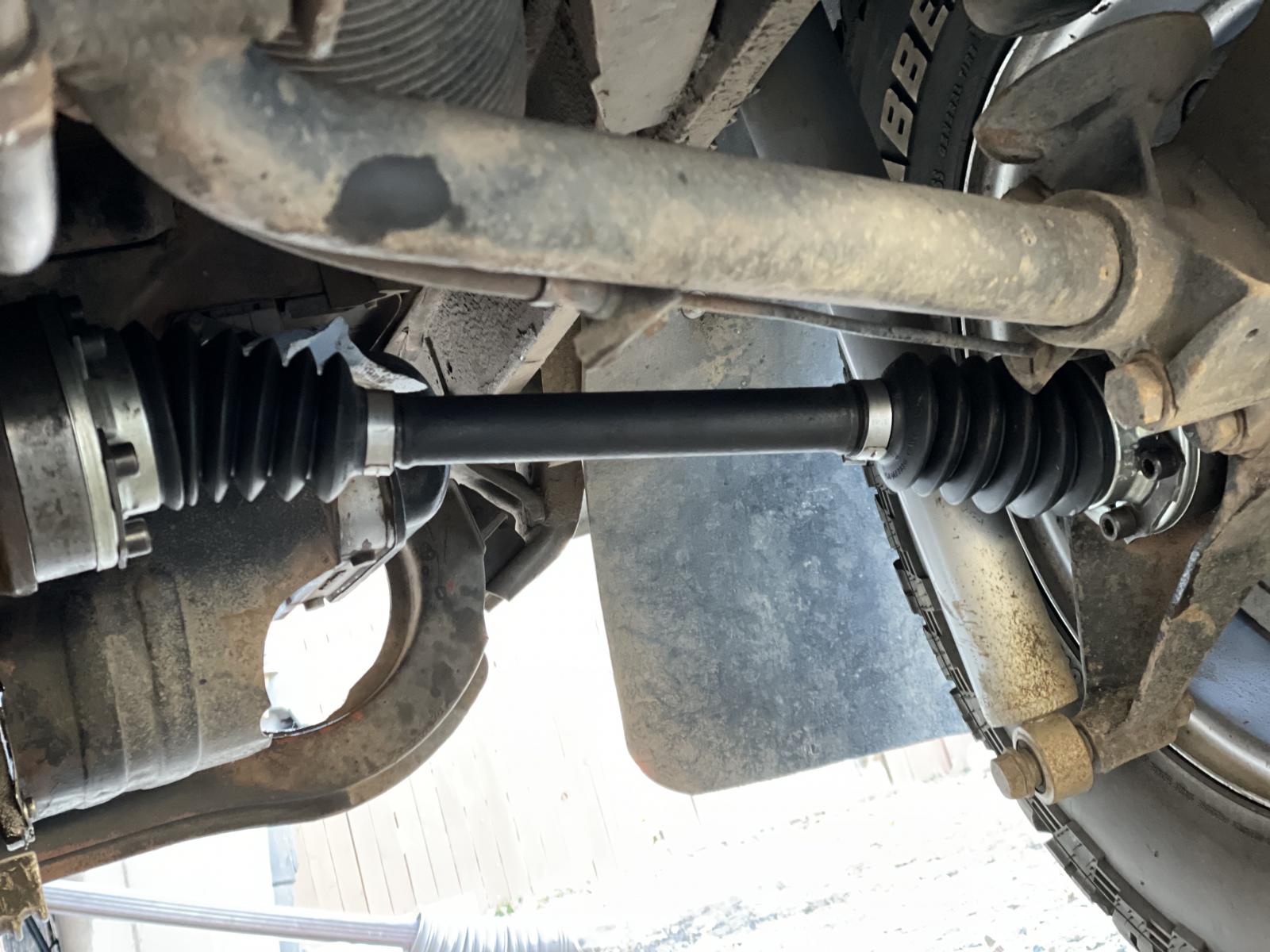

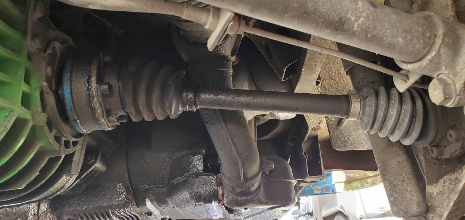

Anyway, I was under the Bus last week cleaning the grounds and starter cables and noticed the condition of the boots.
Here is the driver side. As viewed in this pic, the stock replacement that was sourced from Bus Depot (ordered in 2018 and stored until Jan 1, 2020) is on the transmission side, OEM VW Tiguan boot is at the wheel.
Stock replacement boot on this side is leaking grease out the axle side, causing a large mess. The rib doesn't appear to be cracking though.
The Tiguan boot looks perfect if dusty.

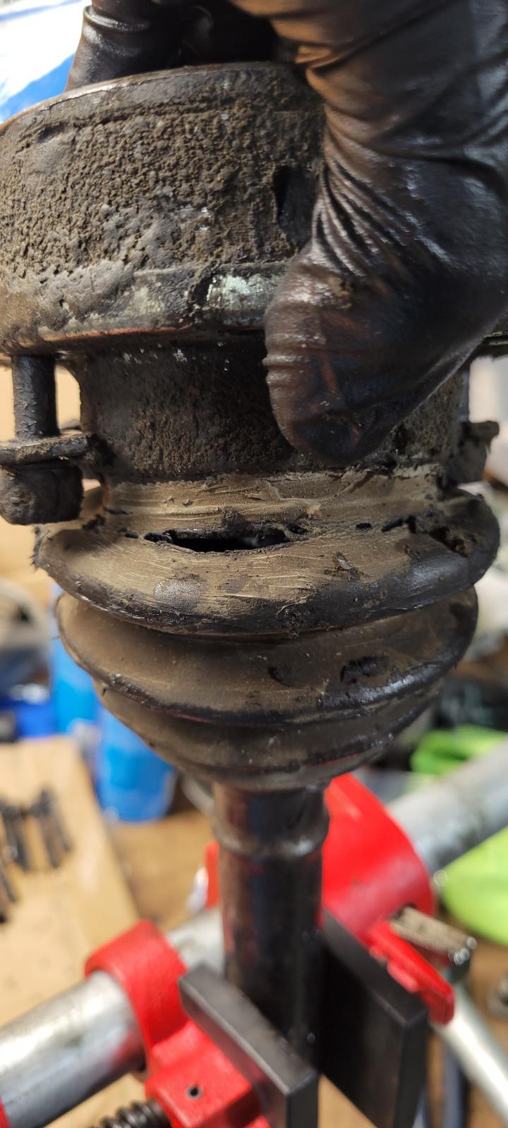

On the passenger side, the boots are both starting to crack right at the axle.
I do wish I had two Tiguan boots and could have done a whole axle for the experiment, but alas I didn't.
Actually, at this point, I kind of wish I had installed 4 Tiguan boots! It looks very clear at this point that the Tiguan boot is going to be the winner of this experiment.

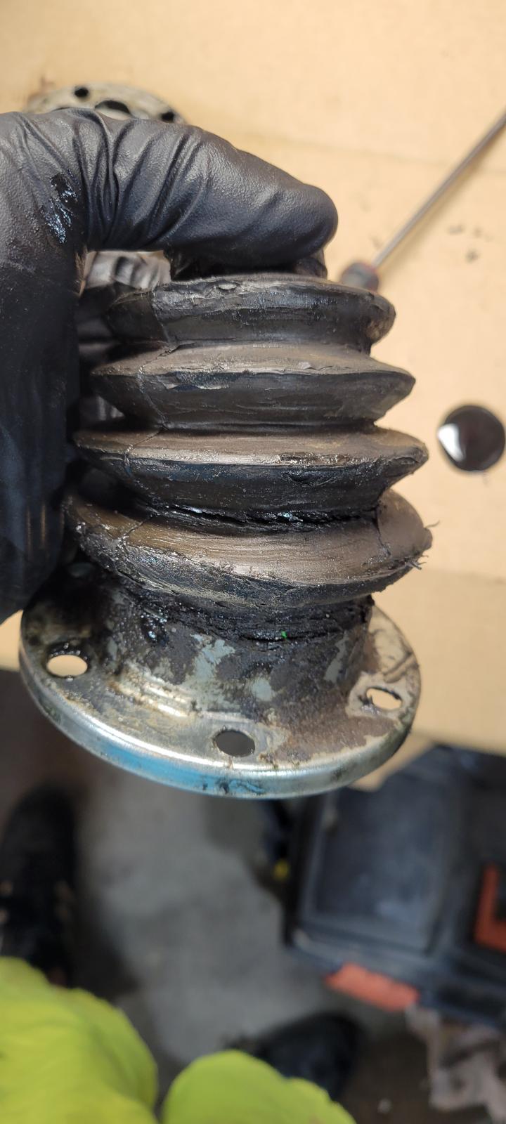

Those Bus boots had some cracks and holes in them. At some point, I noticed that they were starting to crack (but hadn't fully through) so I smeared some RTV on them hoping to get a few more miles out of them. Don't know if that really worked, but that's why you can see it on the boots.
Here's a couple of the replacement Bus boots, other one still needed replaced too:
Dead after 5 years and roughly 10,000 miles.

KentABQ wrote:
Those boots are listed at $47.69 now.
But if they last, they're still worth the price.
Yup, looks like the price went up. I bet I got a Xmas cyber deal.
I borrowed a crip tool from a buddy and finished up the axle rebuilt and installed them. They fit perfect and look pretty good. I will update in the future with their durability.
